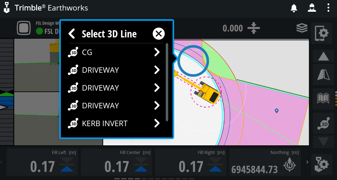

As long as your linework is named in TBC and you export a VCL file of the data, you should be able to tap and hold on the "plan" view and use the Select 3D line option, then the lines will display with their names.
This is in the current version of Earthworks V2.20. Not sure if this line naming only came in at a certain version or not.

I'm going nuts here. I know that there is a way to export line work named so the operator can know exactly what line to select, but I can't figure it out. The VCL is loaded and the layers are all active except for "Site Linework."
Why am I stupid and please make me not stupid anymore
