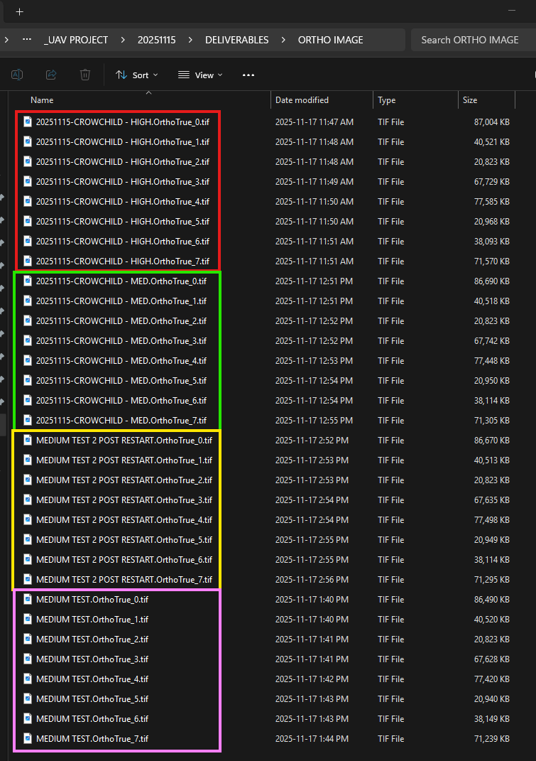

    Just came across this issue today. (Version 2025.20)
    Still plagued by the fractured UAV deliverables (That's a discussion for another time) I opted to reduce the quality in an effort to get the entire area into a single image.
    Noticed that the medium quality deliverables were the same size as the high quality. Thought it was my mistake for not correctly selecting the correct option.
    Reprocessed another time just to be sure and again after a full system power cycle
    Rory Prendergast

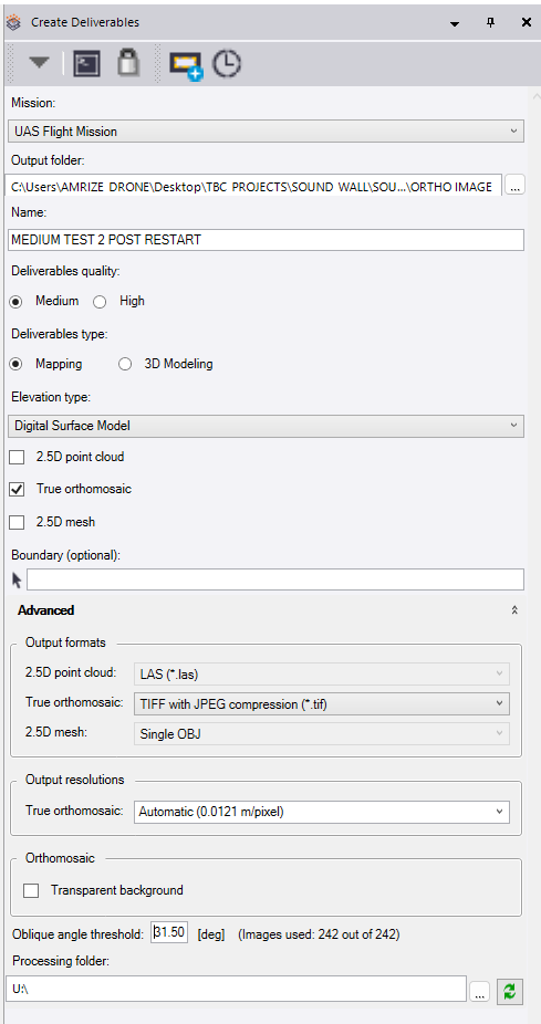

    we made changes to the processing engines, impacting the "Digital Surface Model" selection.
    Digital Surface Model focuses heavily the true-orthomosaic generation in our production. Both, Medium and High, are running the pointcloud on the highest resolution, allowing with both methods to generate a high-detailed true-orthomosaic.
    Medium uses some speed improvements, as some of the internal processing steps do not impact the final deliverable of the true-orthophoto as much and allow us therefore to create the true-orthomosaic with some processes being executed on lower level content internally.
    High adds additionally some edge-enhancements, so if the drone flight includes enough overlap, you can see better solutions for High then Medium for buildings. We left Medium and High as options, but will in the future move the "High" option to the advanced option.
    You can always manually change the orthomosaic resolution to a lower GSD, creating smaller orthos but also lower resolution of course. Just click on the [Automatic (0.0121 m/pixel)] enter the GSD you want into the:
    Output Resolutions
    True Orthomosaics: _______
    We announced the change in the release notes for TBC v2025.20, but sorry if this did not reach you.

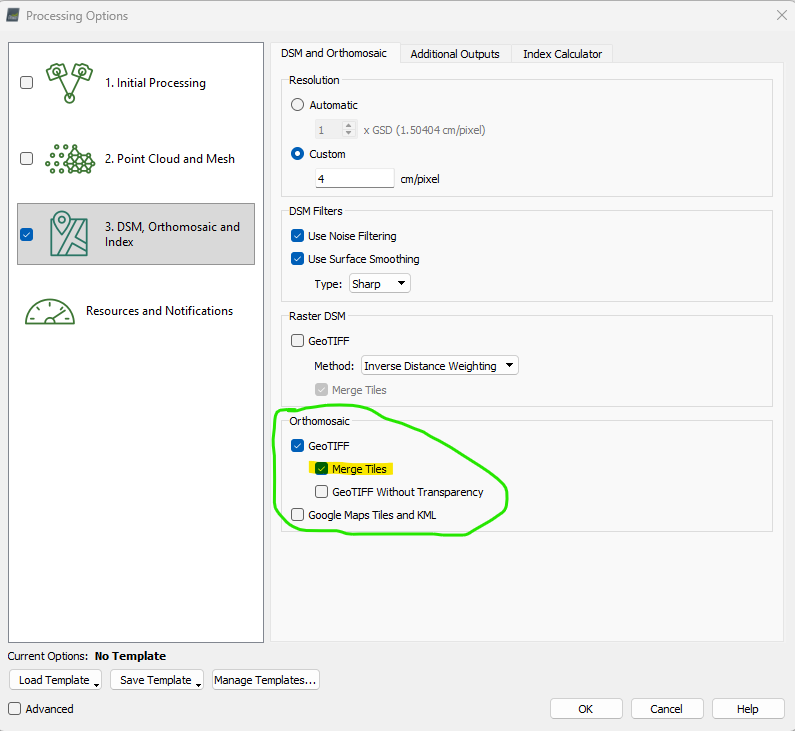

    Merge tiles option as seen in Pix4D below.
    Rory Prendergast
