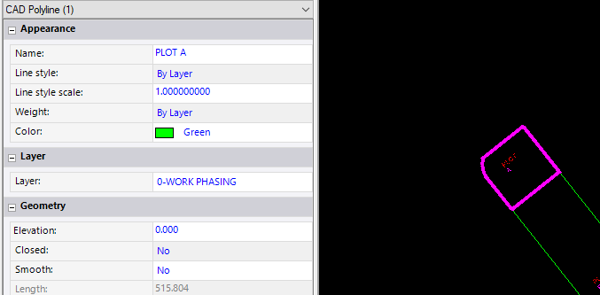

    I have two surfaces imported from xml files.
    I have imported a dwg file consisting of polylines and some text.
    Intention is to create Plot Boundaries from Plot A to Plot J and find surface comparison quantities all those plot boundaries.
    I am unable to:
    1. Pick any polyline and name it
    2. Create a new polyline on top of the existing polyline/s.
    What may be causing this issue?
    I tried to "Explode" all objects on the layer without success!!
    Could some one help.
    Thanks.

    Rectangular snap was the issue. Now sorted.
