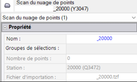

    Since then I can see the file in my project explorer with all my stations, all .tzf files are well copied in my desktop folder (with equivalent file size as my source from my X7) but all my scan point cloud have 0 points in them when inspecting the properties.

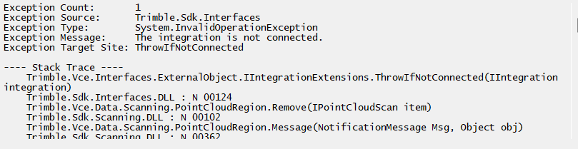

    I wanted to remove this file from my project but when trying to do so I got this issue :
    I can't import new .tdx file anymore, neither remove this one blocking my project.
