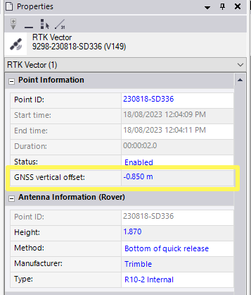

    When collecting field data for service locating, trimble access has an awesome feature of being able to input a vertical offset to denote the depth of a locating mark instead of adjusting the height of the gps pole. This value gets saved with in the point meta data that can be reviewed in TBC in the points list in the RTK vector.
    What smart text code can i use to reference this value as this would be an easy way to denote the depth of a service on a plan?
