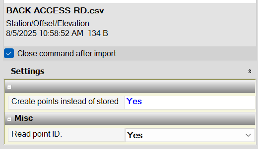

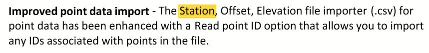

    v4.1 of BC-HCE added the ability to read Point IDs in an SOE file
    Then in v5.10.2 they added the alignment selection.
    And in v2025.10 they took it all away. SOE files cannot be imported at all, based on my testing.

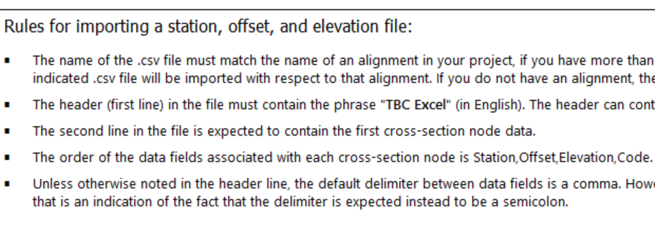

    The help documentation reverted back to pre-v5.1 where the file name had to be the same as the alignment.
