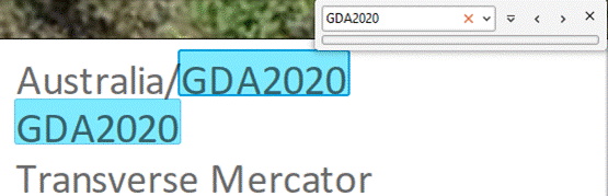

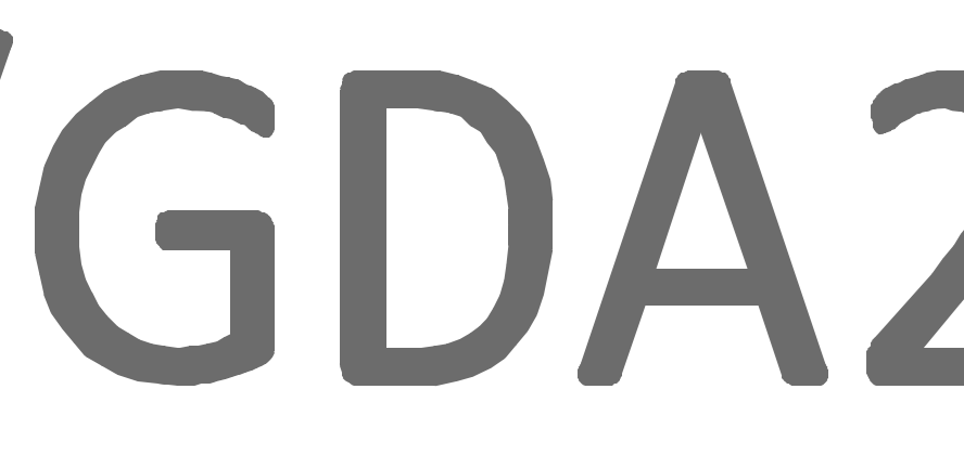

    You guys need to do a better job compiling the release notes, the Access guys seem to do a much better job in that regard.
    I just stumbled over something in 2024.10 that we've been begging for since years (since about 2020 at least) and it was changed uncommented.
    TrueType font is suddenly/finally plotted as searchable text into PDF, and not linework anymore. Unbelievable that I see this before my retirement, that I can tick something off my TBC-Issues list.
    View priority is still wrong by the way, whiteout issues have not been resolved .................
    2024.00 is still linework
    2024.10 is finally searchable text
    There was also an undocumented change when it comes to IFC rotation TransformData is deteriorating the object origin | TBC Macros and Extensions
    And who knows what else is missing from that list.
