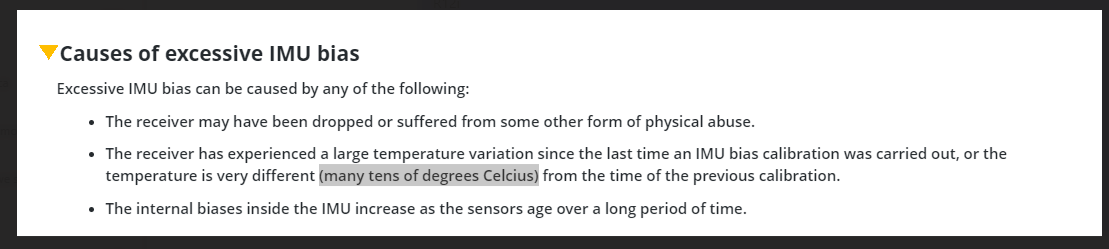

    We consulted our Trimble distributor, when do we have to do an IMU calibration on an R12i, and we were told that it was 10 degree Celsius.
    I found this on line:
    In here it says many tens of degrees Celsius.
    Can someone from Trimble tell us what the temperature change from a previous calibration is to re-do the IMU calibration on the R12i.
    I ask this question because here in Calgary, Alberta, the temperature in the morning can be 10 degrees and in the afternoon 25+ degrees (during summer)
    Do we have to do a calibration every day?
