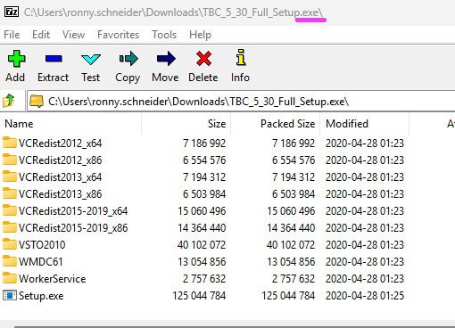

    The offline installer usually comes as ZIP.
    The older ones came as .exe but were basically just an executable ZIP. They looked the same as the normal ZIP inside.
    It is advisable to unzip the file into a temp folder first and start the Setup.exe from that folder. You don't have to do anything with the subfolders.
    If the installation ran to the end and you restarted the computer, which is often required, and it won't start at all I'm a bit at a loss. I'll need to see if I can replicate this somehow. My private machine has several old versions installed already, including this 5.41 and newer ones, so the installer refused to do anything when I tried to rerun it yesterday. I'll need to see if my other old laptop is still working and if it hasn't got any TBC on it yet.

    Thanks, Ronny. I'm fairly sure I unzipped the package, but after reviewing your message, I suspect my installation approach may have been incorrect. I believe I went into the TBC subfolder and ran the installer from there, rather than launching the main Setup.exe located at the root of the extracted folder.
    I'll try this again properly when I'm back in the office tomorrow and will let you know how it goes. Much appreciated!!

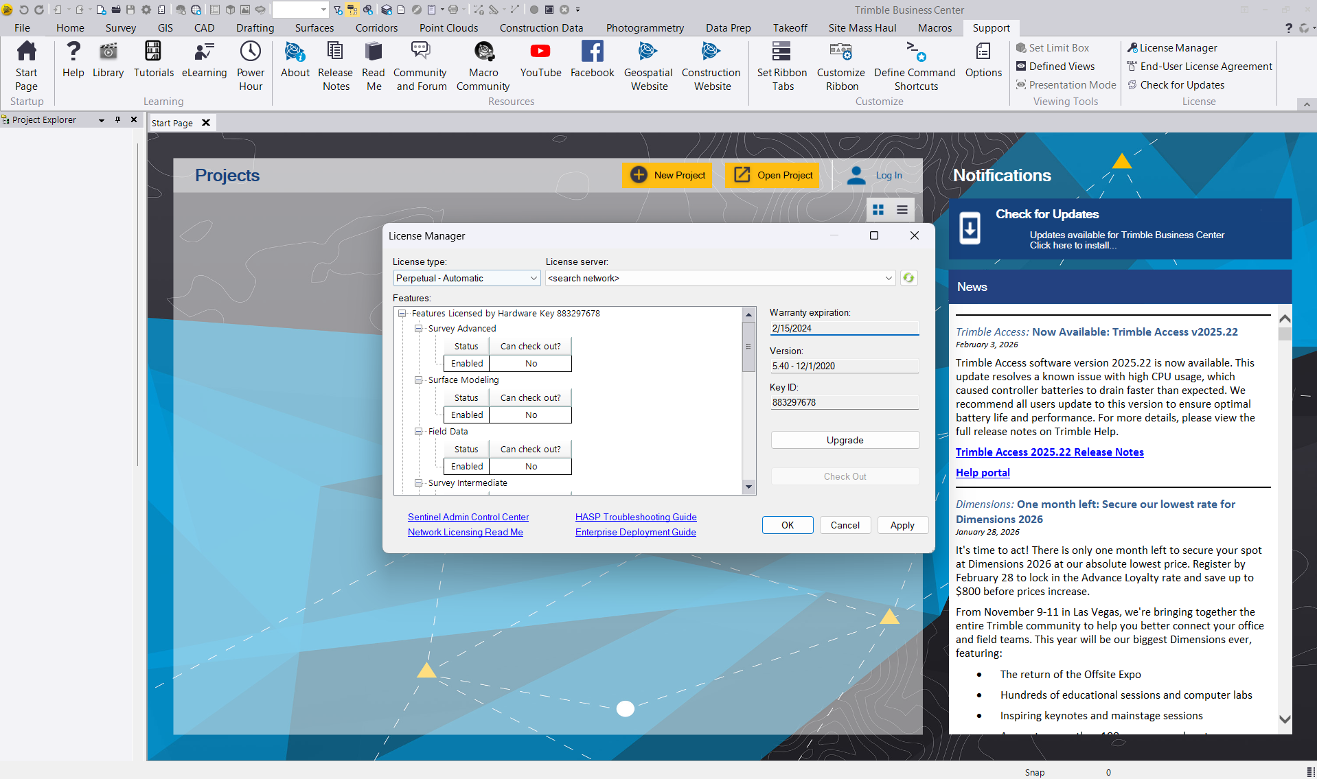

    Hi Ronny,
    I was able to successfully install TBC 5.40 using the file you shared. Thank you again for your help, very much appreciated!
    I have one follow-up question regarding licensing. The dongle I plan to use on the laptop where I installed TBC 5.40 shows a warranty expiration date of February 15, 2024. My understanding is that this should allow me to use any version of TBC released up to that date, which I believe would be TBC 5.90.
    I was hoping to upgrade using the "Check for Updates" option within TBC, but it only appears to show the latest release, which I understand I would not be eligible to use.
    Could you please advise on the best way to obtain and install the appropriate version (up to 5.90), or let me know if my understanding is incorrect?
    Thanks again for your support. I really appreciate it!

    According to this dealer's webpage, the most recent version for a warranty of Feb 15, 2024 would be
    TBC_2023.11_Full – Warranty Date: October 1, 2023
    https://frontierprecision.com/support/tbc-downloads/
    Quan Mueller
