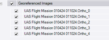

    Still testing out the photogrammetry module of TBC. For some flights it creates 1 orthophoto, but for others it creates 5. How can I get it to just create 1?

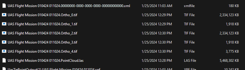

    The .tiff file format has a physical file size limit of about 4gb, so TBC has to split larger flights into more than one file to keep each file under this size.
    If you need it in 1 file you can try lowering your deliverable resolution down if thats an acceptable trade off.

    Another solution would be to ensure all of your flight have been merged into one mission using the Merge Flight Missions. This must be done before proceeding through the adjustment process.
