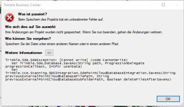

Ever since we upgraded to 2024.00 I have been getting save errors on my network drives. Saves successfully the first time but then the next time I save I get this error.
Doesn't happen if I roll back to previous version.
Anyone experienced this?

Same Problem, when i will save on an synology server.
When i save the project local, it works.
Trimble TBC Version: 2024.01 - 01.05.2024  on an Windows PC.
