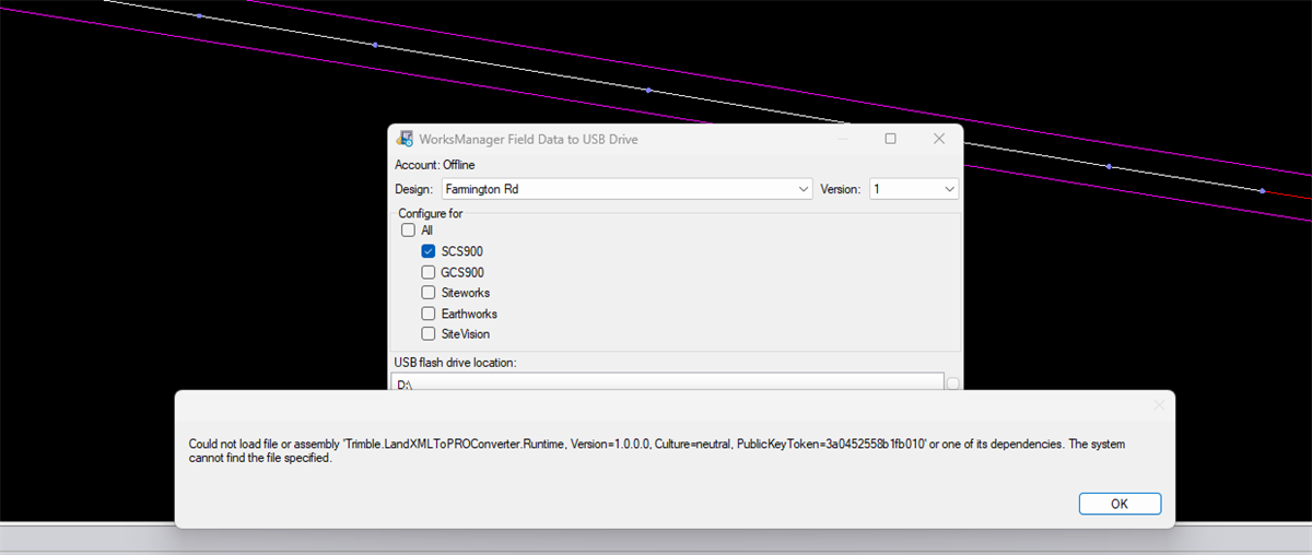

Hey Fellow TBC Users.  Noticed a bug in 2025.10 and it appears we are no longer able to export.pro files for our older SCS controllers in the fleet.
We get the error message attached that it is no longer able to find the landxmltopro converter.
Could really use some advice that will allow us to remain on the latest software and still export out alignments for legacy controllers
Error for exporting .pro lor legacy software controllers
Any Help is appreciated

Jake,
Not sure if this will work, but I create .pro files by using the Field Ribbon in TBC. First I set up a Job Site, Then in Design I create either an Alignment Design or a Road Design. It creates a .pro file for me in the trimble sync folder.
Hopefully you can get this to work.

Hi Jake,
Please add this dll file to TBC 2025.10 installation folder (should be something like `C:\Program Files\Trimble\Trimble Business Center`).
https://drive.google.com/drive/folders/1RYLFtckAzjLG7Ydg8R4xFbMFygT3UGP1?usp=sharing
I get this dll from Trimble and it worked, so I could export a pro out of TBC 2025.10.
In TBC 2025.20 I am able again to export pro.
