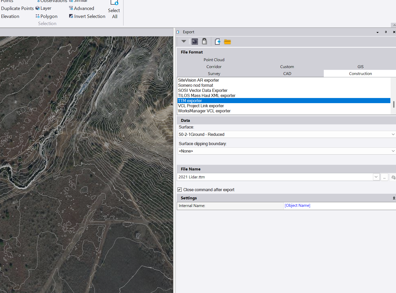

one option might be to export xml of the triangles. pretty sure you can do this without having all the associated points but not 100% sure. then reimport the surface from the xml. if the triangles are dense then you might still have large files.
Thomas Tomsu's profile image
Thomas Tomsu
I usually export surfaces in the Trimble format "TTM", they seem to be lighter than xml. Since it is native to TBC, it holds all breakline and triangle data that you originally had.

Workflow should be:
  1. Create new TBC Project for every date surveyed
  2. Import Point Cloud
  3. Create surface
  4. Export TTM file of surface
  5. Create " Master" TBC Project  and import all surfaces for comparing
