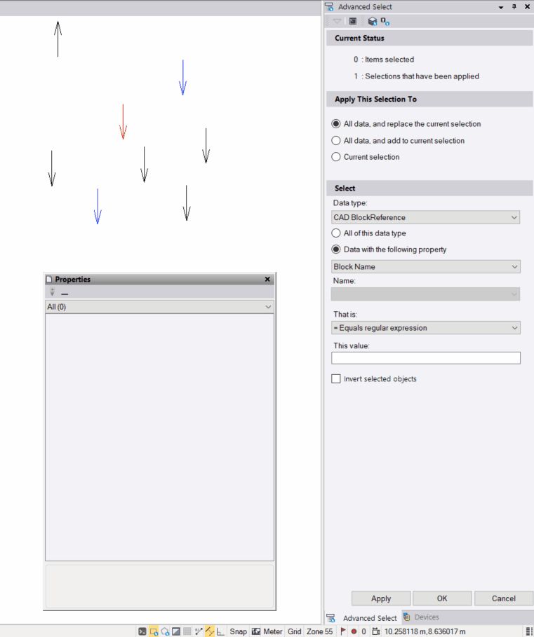

I am working with a large amount of CAD blocks and I want to change one block reference, used by multiple blocks in model space, to another.
Example;  change all instances of WM1 to be EP1.
Block reference WM1 -> EP1
I feel like there was an 'Express tools' ribbon menu but cannot find it anywhere after my 5.7 update.
Thanks in advance !
Dan
Ronny Schneider  Best Answer
Advanced Select on the whole dataset? That can work independent of Layers.
I might be misunderstanding the question, but isn't it enough to just change it in the properties window?

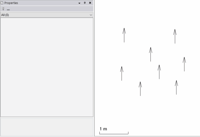

@Ronny Schneider, Thanks! Yes... But also, no.
I am cleaning up an old messy dataset and the blocks are identical across numerous layers and scattered throughout the data. ​
I am working through it but it is taking a long time to select individual blocks with the size of 0.000002 haha.....
I found the tool that allows me to do that in AutoCAD but I would like to avoid exporting and re-importing in my workflow.
Cheers
Daniel Lohrey's profile image
Daniel Lohrey
@Ronny Schneider
Thanks so much! I didn't think to try that!
Cheers​
