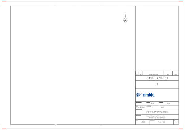

I've had this issue for quite some time now and it has stopped me from upgrading my version of TBC from v5.6. I think i'm right in saying that this topic has been discussed up by @Alan Sharp from Rockpile Solutions where when you export a drawing from TBC,  in AutoCAD the blocks have been scaled up by 12. I thought thgis issue was going to be resolved in v5.7 but in trying the latest v5.8 the issue i have still appears to be there.
In TBC the my North arrow block appers at the correct scale for the drawing...

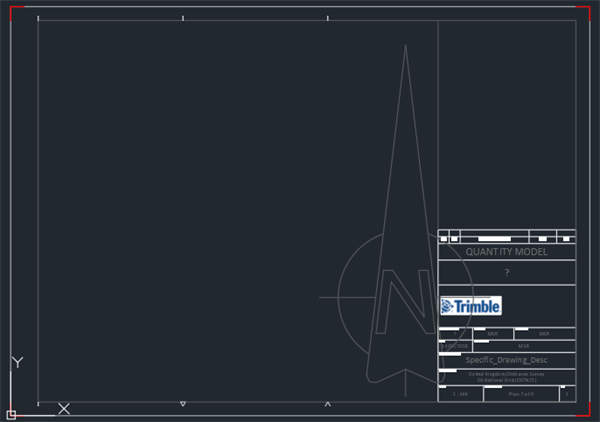

But in AutoCAD the arrow is the wrong scale...
Can antone help me out with a solution to this or a work around?

Brett at Trimble Support has replicated the issue and has an open support ticket on it. Be interested to hear if anyone else has a short term fix on this one.
