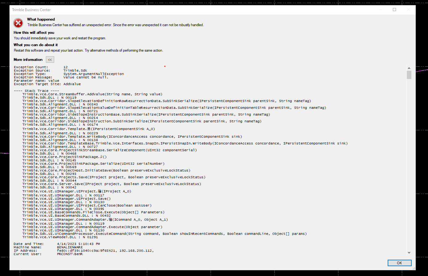

I keep getting this error and it looks like it doesn't like something with my template.  I have checked all my templates and they are good and the models are built.
But when I try to save it says this, and wont allow me to save or export the vcl.  It did let me export the surface ttm.

No help with getting the file saved, but you might look at exporting each template as an .xml file so you can rebuild it later if necessary. Hopefully there aren't too many. If you have nested tables, a lot of time they don't come through when you copy a template into a new corridor or try to save it another way.

I've had a similar issue when I was saving over a network to our companies save drive and I had an issue with a bad connection (loose cat5 connection).   I tried saving locally and it worked.  Not sure your situation here but worth a try if you are saving over a network.
