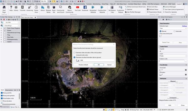

If you have the Scanning module in TBC you can use the "Extract Point Feature" command to do this. When the command is open you choose "Tree" as the extraction type and then go to "Settings". There you will be able to the select how the truck diameter should be measured, you can select "Diameter at a fixed elevation above ground". Added a screenshot for you.
