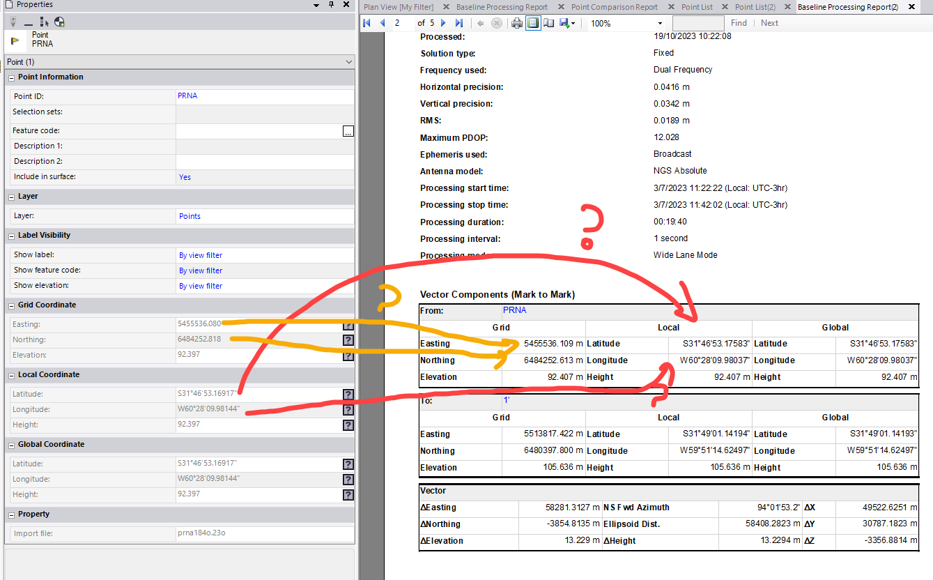

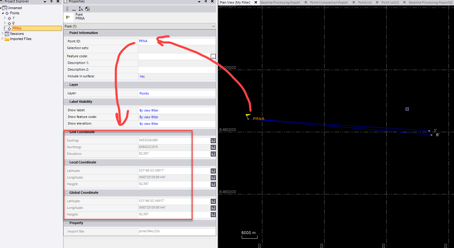

 difference between the coordinates displayed by TBC and those shown in the TBC report
Guillermo Meinero's profile image
Guillermo Meinero posted 10-19-2023 07:50
Hello everyone, I'm noticing small differences between the coordinates displayed within the TBC software and those provided in the TBC report. These differences are very minor, and I can't seem to figure out the reason. Does anyone have any possible explanations?
