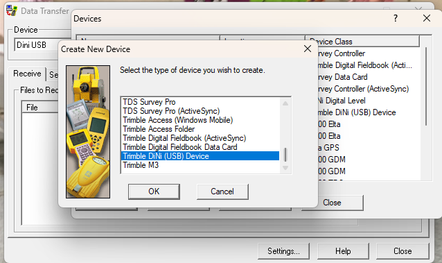

Alex Culbertson's profile image
Alex Culbertson
Hi Brent, I just had this problem with our DiNi level when we got a new Windows 11 computer. I solved the issue this way and I hope it helps you.
  1. Open Data Transfer program.
  2. Click on the button "Devices..."
  3. Click on "New..."
  4. Scroll all the way down the new device list and click on "Trimble DiNi (USB) Device"
  5. Click "OK"
  6. Name the new device and click "Finish"
Alex Culbertson
Hi Brent,
Sorry to hear that didn't work for you. I did want to clarify one thing in case it wasn't clear in my previous post. In your post you mention creating a new device and it was a "DiNi Digital Level". I tried that option too but it didn't work for me. However, further down the list there is an option for a "Trimble DiNi (USB) Device" that one did work for me.

Having this same issue, I have loaded the drivers and device manager shows Trimble device working properly. however the only DiNi device available when creating a new device is Trimble DiNi (COM1) there is no option for Trimble DiNi (USB), what determines what devices are available in the create device list?  BTW Running Windows 11, 24H2.  Any Help would be greatly appreciated.
