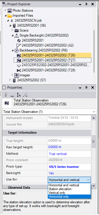

I have completed a traverse and found that my horizontal distance readings between two points do not match.
Is there a way to disable or correct the one I assume as being wrong?
If so, how can I achieve that?
Many thanks
If you select the total station observation in the project explorer (or the view) you can i.e. set the "Use for" property to "Vertical Only", or set it's whole "Status" to disable. Or change the prism constant to the correct value.
Ervin Gergely's profile image
Ervin Gergely
Thank you for the ideas. I believe the vertical only option will also disable the horizontal angle - something I want to keep, while setting status to disable, will disable the lot. Adjusting the prism constant should sort the issue for me, thank you.
