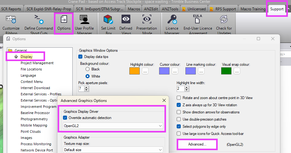

Have you changed the graphics mode (in options) to OpenGL and restarted TBC?
Henry Henderson-Genefaas's profile image
I have tried changing the graphics display driver to OpenGL2 and restarted with no success. I have also tried using DirectX 11, and it doesn't solve the issue either. I am going to try and install some new GPU libraries to see if this helps
