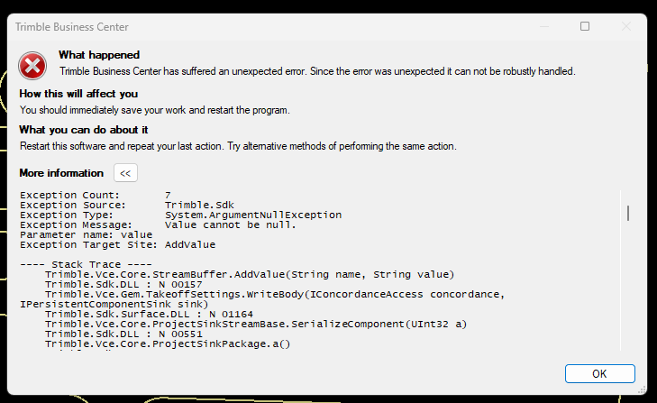

I've seen this has been asked a few times over the past several years. Curious if there has been an identified solution??
Getting this error when trying to save. I've tried "Save As" still not working as I get a "not a properly formatted path name."

This is the response support gave:
As for the error you are seeing this is a null reference occurring within the Takeoff module where TBC is trying to save your project, but it has encountered a blank or missing value in your settings where it expects data, causing the save process to crash.
You likely have a boundary or surface assigned to a Material or Site Improvement that was recently deleted, renamed, or left unselected. TBC is looking for that "Value" and finding "Null" (nothing), which prevents the file from writing to your disk.
Please recheck your Project settings and data as well as the MSI manager for that.
You may also clean your project data using the Purge command or export your project as .vce to move your work into a fresh, clean project template

@Jay Pisano, do you see the "not a properly formatted path name" message after the red X "What happened" window?
@John Woodall, do you get the same Exception Type = System.ArgumentNullException, and the 3rd line in the Stack Trace refers to Trimble.Vce.Gem.TakeoffSettings.WriteBody()?

Thanks @John Woodall, Jay's underlying issue might be different than yours, but you are both seeing a "not a properly formatted path name" message that is a generic troubleshooting message.
I'm curious about what TBC version Jay is running because that error screenshot (and the response from Support) indicate there's a TBC bug putting the TakeoffSettings into a bad state.  Hopefully it's been fixed by now and the workarounds helped Jay...
