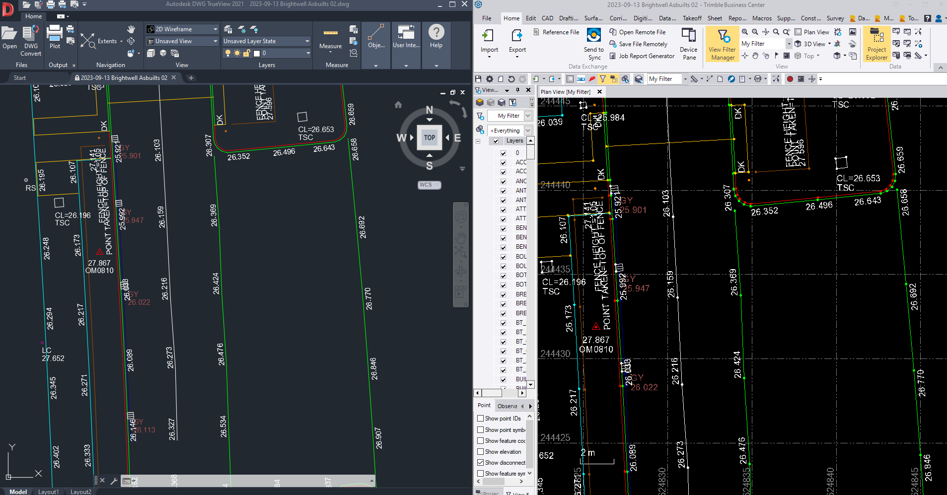

I am having a re-occurring issue when exporting to CAD a survey I have draughted in TBC
I use an FXL to draught my surveys, process feature codes and then carry out a small amount of editing in TBC
When I try to export everything to CAD then a lot of the time either not all linework comes through and/or some of the text edits get reversed
Does anyone know what the problem might be? Or is this a bug?

I was able to export all the data as a DWG.  Looks to be all there.  If your exporting as a DXF, try the DWG option.

Thanks for trying to replicate the issue. That's strange as my colleagues are also experiencing the same problem. What version of TBC are you running?
Is it possible to upload your exported CAD file please?
