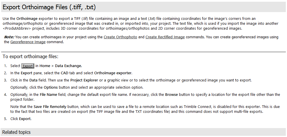

We are trying import a GeoTIFF file into TBC, change the coordinate system and geoid for it, and then export it out of TBC.
The first two steps are easy to do but we can not seem to figure out how to export out a GeoTIFF in TBC. Or maybe their is a better way to do this. Any help would be appreciative.

Hi Evan,
Have you tried this work flow for the export of the .tiff?
