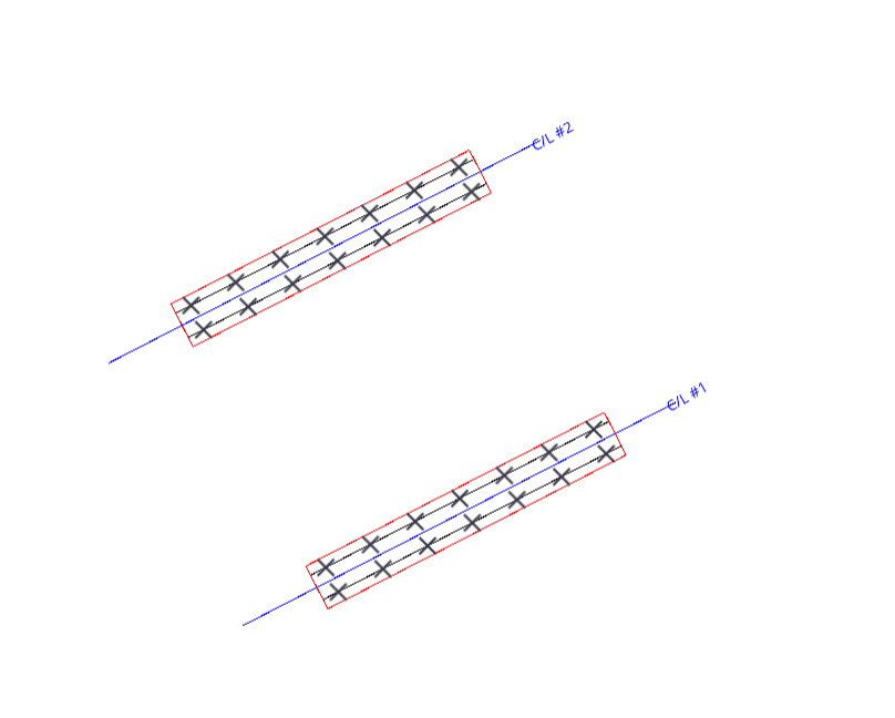

Erik Petersen
posted 06-10-2022 11:31
is this CSV under the design? They should be showing up as Xs on the screen
