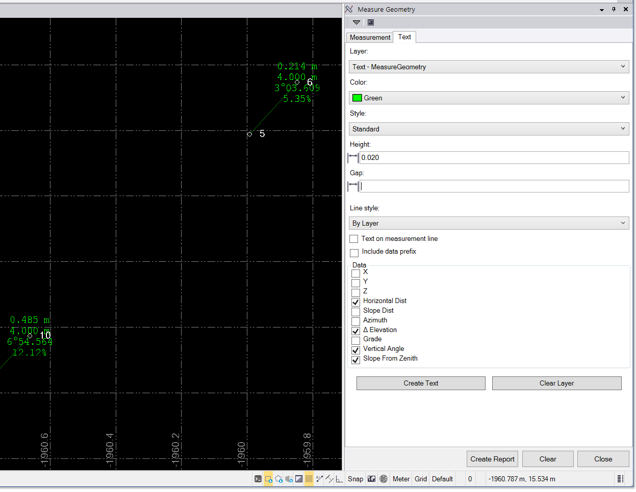

can we please add vertical angle and slope (%) from zenith to the measure tool and also smart text? I am currently required to plot pile position, elevation, and verticality. I've measured center of pile at the bottom and top before driving. and now calculating VA with trig from the horizontal distance and delta elevation.

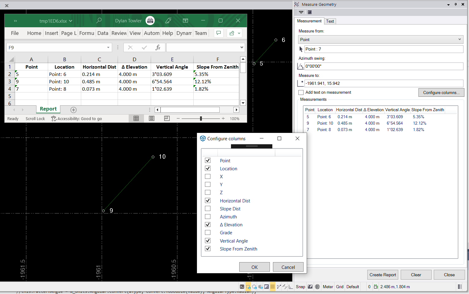

I think you're one of our customers so you should already have access to the ANZ Toolbox. We have a command called "Measure Geometry " in Beta that I think will solve this problem for you. It allows you to select a Line or a Point and then measure various geometric properties in relation to other points/nodes. You can then create an excel report and annotate text (with a bunch of options) to a specified layer. As with all of our measure commands you can configure the columns and the text annotation fields you want to be visible. See screenshots below for the configuration I think would work for the workflow you describe.
As I mentioned this hasn't been released yet, but if you get in contact we should be able to provide you with a Beta Build.
