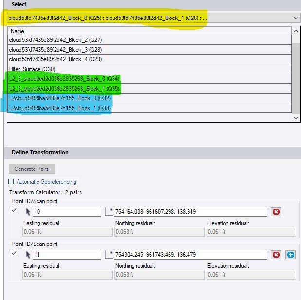

I am trying to georeference  aerial data from multiple flights into one drawing. The data sets are large and come in as blocks. Highlighted in Green (2 Blocks) is one flight and Blue (2 Blocks) is another. Is there a way to create a custom point cloud set like the auto set highlighted in Yellow? I would like to group Green as one set and Blue as another set.

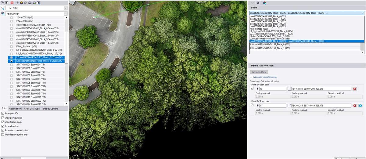

Currently every time I try to georeference the Blue flight point cloud the Green flight moves with it. Even when I only have the Blue set selected. How do I properly set it up to move each flight individually  to get them georeferenced?

Currently all your scans are linked together, that's why they move together. You have to use the "unlink" in Pointcloud/Register scans/Pairwise to disassemble it and then reassemble it as you like.
