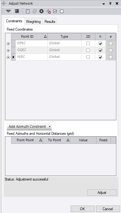

I have three permanent base stations and made a two-hour survey of a single point in static mode with a R8s antenna. For that point I am interested in the vertical ellispoidal height, the accuracy on the horizontal is much less important. I understand I zould have to process the baselines and apply a network adjustment. However, I am a bit confused on which boxes I would have to thick in the network adjustment screen, or in other words, whether I should fix the 2D or h for my base stations:
If I only tick the h boxes, I get a height error of just 1.8 cm. Does that mean that the resulting vertical ellipsoidal height accruacy is indeed 1.8 cm?

The check boxes there represent fixed values in your network adjustment. If you check 2D, you're telling TBC to constrain (i.e. set standard error = 0) that point's existing northing/easting (or lat/long) value. If you check the 'h' box, you're doing the same for the station's ellipsoidal height. Whether any given point should be held fixed or not is a survey judgement matter. It's really up to you to determine what is appropriate for your project and what you're observing, because there are so many variables involved in this that it's impossible to provide a direct answer to your question without being deeply involved in all aspects of the project.
I would recommend running the adjustment numerous times with different sets of parameters, examining the results, and picking the solution that you feel is the best. I would typically start with the closest reference station held fixed, and leave the others unchecked. That gives you 2 reference stations to use for checks. Since static is sensitive to base line length, the closest reference station would theoretically offer the lowest standard error, but this is highly dependent on the magnitude of your base line lengths (2 miles? 20 miles? 200 miles?) and the difference in length relative to the others.

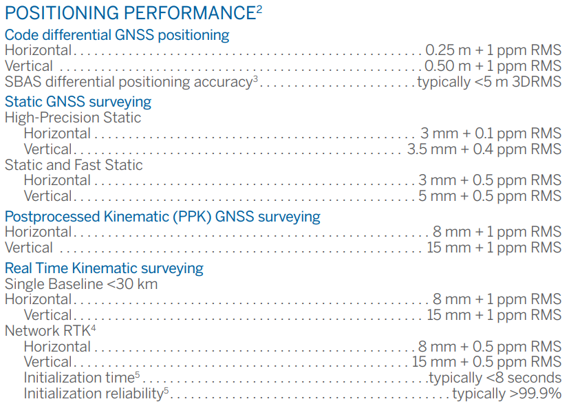

@ian bissonnette I won't pretend to understand this on the level of Seeber, so for the sake of transparency I'm basing the statement regarding the correlation between standard errors and base line length on the datasheet for the instrument. In this case, the R8s was mentioned:
It is my understanding that the ppm component is derived from the length of the baseline and added to the fixed/nominal standard error. At short distances, the effect is negligible but at longer distances that 0.5ppm can become significant. I believe this is largely related to the lack of correlation of atmospheric conditions applicable to the two stations, but the amount of time that has passed since I learned this stuff leaves me questioning everything I think I know :)

scott. thanks. of course it makes sense to look at the spec of the gear. i guess the thing is that the numbers are pretty negligible for static. from my quick calc the ppm on 10km being 1mm in horizontal and 4mm in vertical. these seem pretty low but should be added to the consideration. but you are right on a 100km tie the ppm would up to 40mm in vertical which starts to be something.
