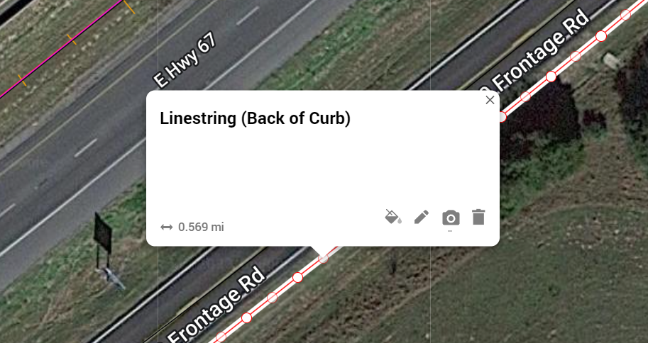

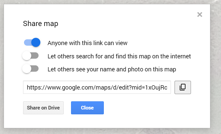

My previous go to for sharing maps beside using Google Earth.  Is/Was going to "goggle mymaps".  if you have a google account you can upload upload KML.  from there you will create a new mymap and upload the KML.  use the share button and can send it out to anyone that you send the link to.  on their mobile device as long as they have a Google Map app,  it will open that KML.  screen shot of one of the project i did.  I did this to use on my iPad before.   was trying to add a screen shot of one of my maps.  guess images is to large.
