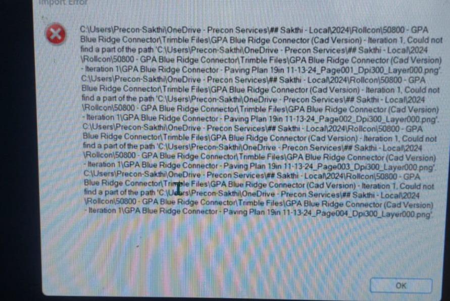

 I can't Import PDF File into TBC Can anyone help me to get this sorted out. Please find the Image below to analyze the issue
Sakthi Manoj T's profile image
Sakthi Manoj T posted 11-28-2024 01:18
This is how it shows when i try to import

by chance you have the PDF saved on Onedrive.  If you have the PDF saved somewhere beside your C drive.  Save the PDF to your computer and try again.

Check that your default processing file location is correct (File->Options->General->File Locations) is local and not on a savedrive or onedrive.  I've seen something similar when my machine is setup to work on a network and reference file paths there and then I try to work remote off the network.
