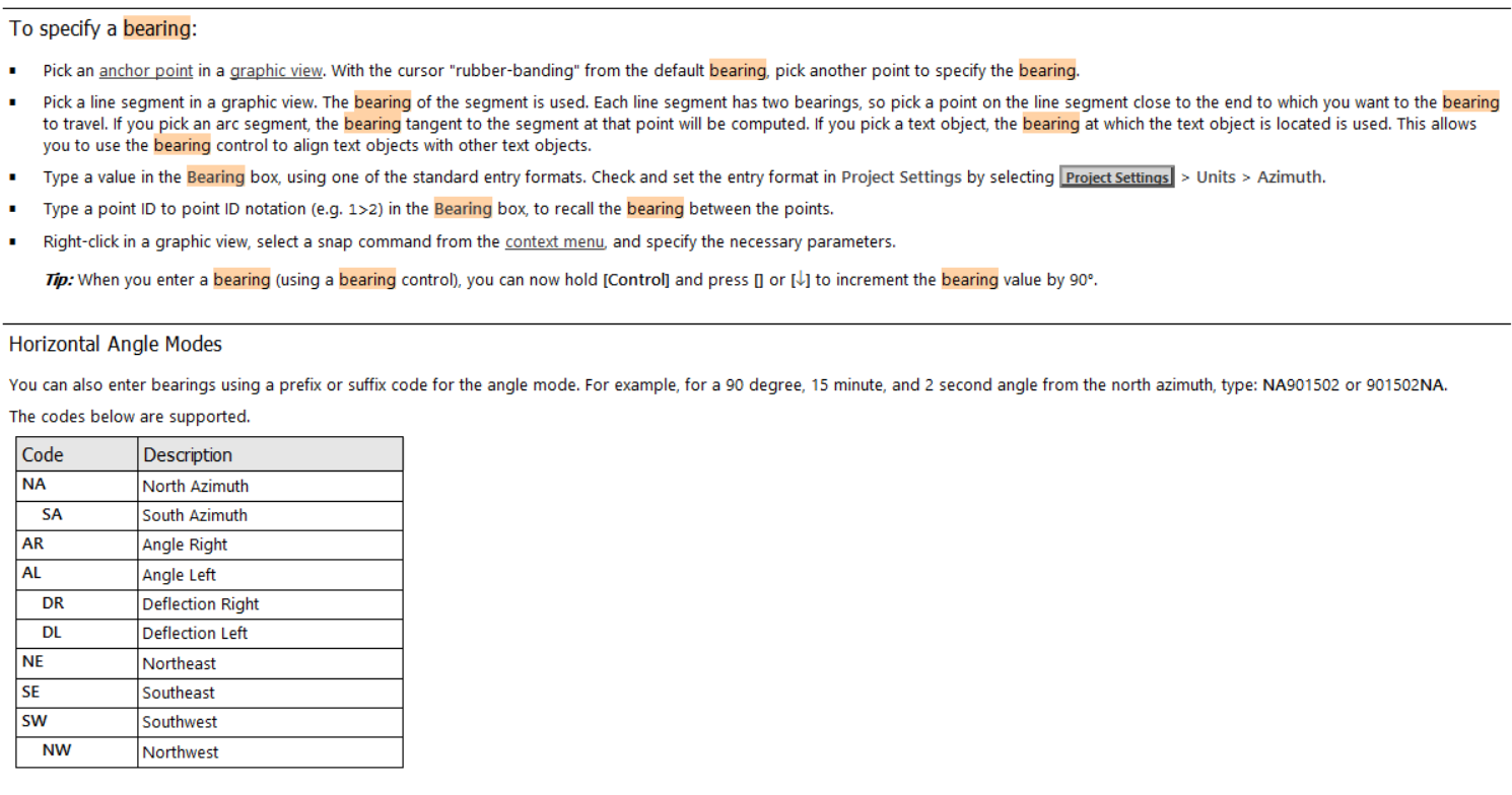

and from the F1-Help

Default setting is for North Azimuth instead of Bearing. Change that, and input bearing without any symbols: S 20 24 41 E
