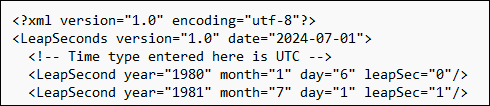

Updated the fix needed as I did have a typo. There seems to be an issue for old versions that has come up and updating the Office Configuration File doesn't resolve it. Our engineering team are aware of this and we will look at whether we need to update the Office Config file to address this issue.
A quick fix on your PC is as follows:
Open the LeapSeconds.xml file in C:\ProgramData\Trimble\LeapSecondsConfig
Edit the date to 2024-07-01

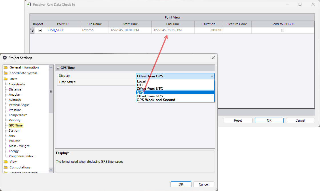

Joel - I am doing some testing for the next update as Trimble was recently notified (by International Earth Rotation and Reference Systems Service (IERS))  there would be no seconds added again for this period. Out of curiosity, are you simply trying to see what time frame the data was collected? If so, why simply update the time to reflect GPS time, or offset from GPS time? The test below is based of a fictitious measurement from 3/5/2045.

Personally, I'm a fan of viewing my data in TBC set to local time.  With an 8 hour offset up here, you can understand the gyrations involved.  Setting to local time is just logical.  From your tests, I think I understand we won't need to see this crazy error (which is in fact wrong "no leap second has been engaged), again.  Thanks for the update.!

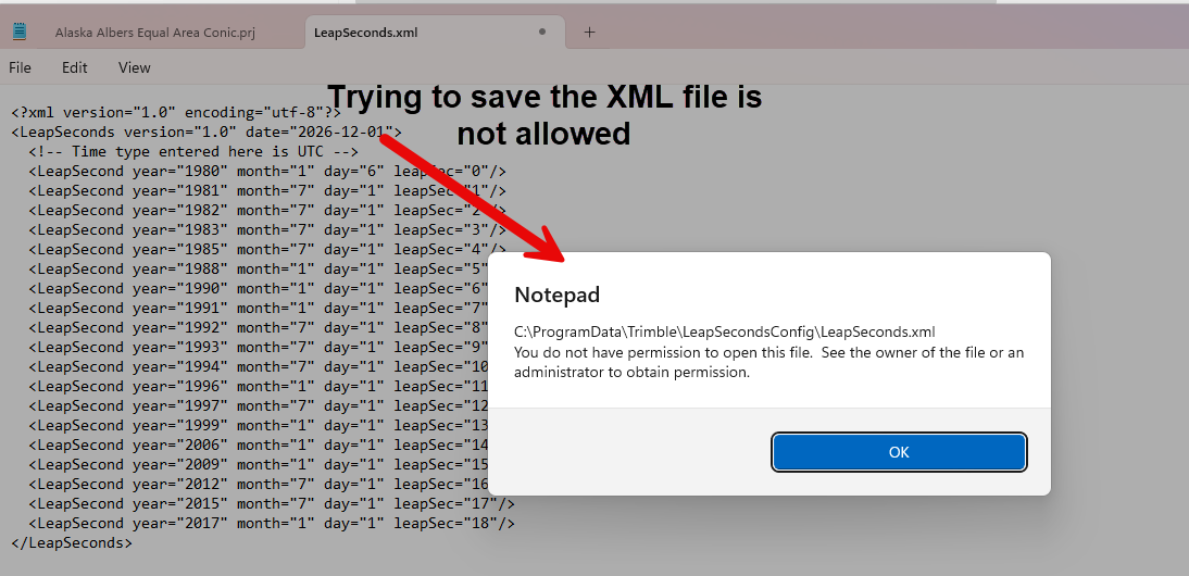

This invalid leap second issue is back once again.  The bug is now a much bigger issue now since users in many agencies (e.g. NPS) have no capacity to edit the XML file without admin privileges.    This is an issue that stops us from processing data after this July deadline, which has a counter set to July 01.   Users have contacted me with TBC version 2024.1 or 2024.1x that this has re-appeared.
Request some method to ensure this issue is resolved.  Updating to most current version of TBC is not possible for all users in this time of disruption that is occurring all over agencies in the Feds.
Per Brandon's response:

Hello Trimble,
I humbly submit this issue has been Answered, but it has not been fixed and this is especially hitting FEDERAL users, and likely other users where IT departments have firewalls in place preventing editing of the XML file produced during installation.   The answer is not "UPDATE TO MOST RECENT VERSION".  There are those that for many reasons need to keep TBC one or more versions behind (aligning with Access is one case).
Running the configuration utility cannot be run by the individual user.  It is also blocked by security and an IT person must run this.
I'll give some fixes:
  1. if you must have this file in the installation package, set the date stamp to a future date beyond July of the current year.   How about 2 years?
  2. Eliminate the Leap second fix altogether except for valid years when leap seconds occur.
This is a show stopper.   We have to have IT to edit this file or run the Configuration utility.   On computers with inTune and Zero Trust environments, only IT can conduct this change.
Please consider the user community here that have security restrictions and provide a solution please.
