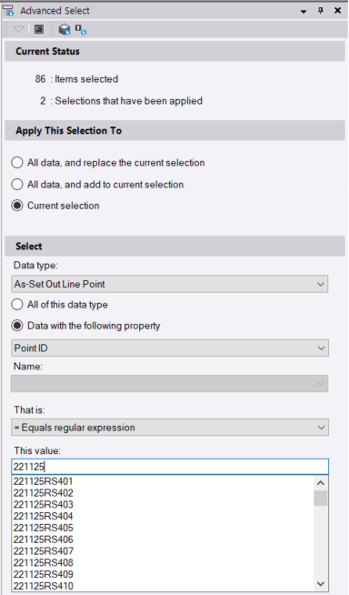

Are those Access or Siteworks jobs we're talking about? Can we see a sample?
And it also depends how your field crew collected the data, as simple measure or as stakeout and how they named the points.
But in general, if your field crew would just use the reverse date in the pickup points, you could just advanced filter for the point ID.
We always use YYMMDD Initial running point number, i.e. 221213RS0001.

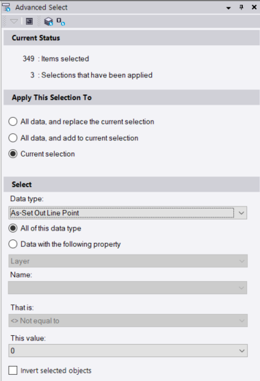

If they are at least stakeout points you can still advanced select just for those.

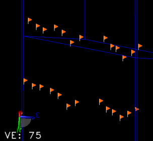

Or use the exaggerated 3D view in order to separate the points a bit more.

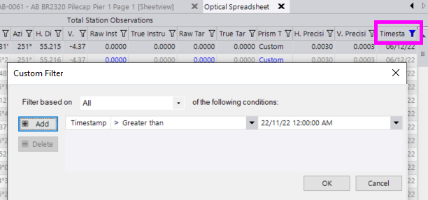

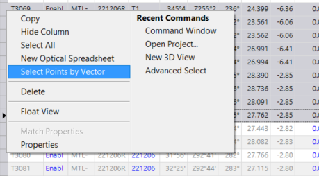

Another option is to open the optical spreadsheet view.
Set a custom filter for the timestamp.
Select the observations and right click "select points by vector".

It does look like I can select the points based on vector though which should be helpful. I also see a similar option for GPS points. When I do the points by vector selection it either gets all the gps or all the total station points but not both. Is there an option that would allow both. I could then Invert the selection and delete the old points. I am not seeing one in advanced select. If memory serves, the data collector (using access) stores imported points as "Keyed In" points but I am not seeing that distinction when looking through TBC.

-select all
-use advanced select to apply to current selection/drop down coordinates/apply
-project explorer/imported files/expand one of the files and if you did not click anywhere else then the 'coordinates' should still be highlighted
-right click and delete
this will delete all coordinates that were imported by csv into data collector and the majority of calcs made in the field
note: the point numbers will still exist.
so now expand the points in project explorer. any point without a drop down will not have any raw data associated and can be deleted(as long as all points have been computed correctly in the project). or you can see them in the point list with no coordinate associated any more.
we also select all asstaked points and right click and convert and then delete the asstaked ones, verifying them in cad.

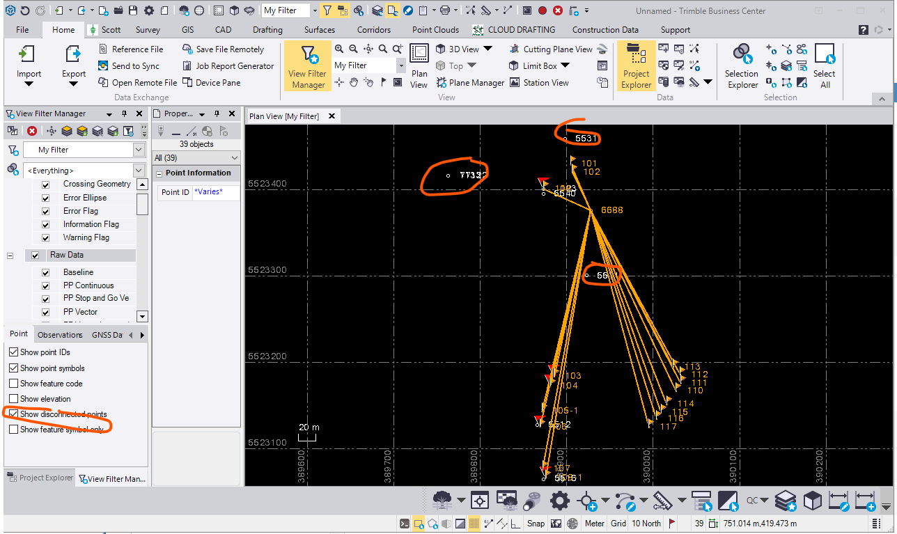

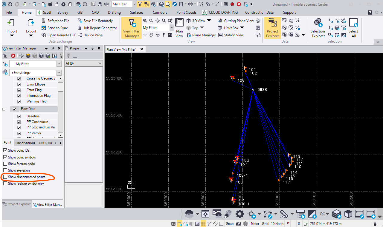

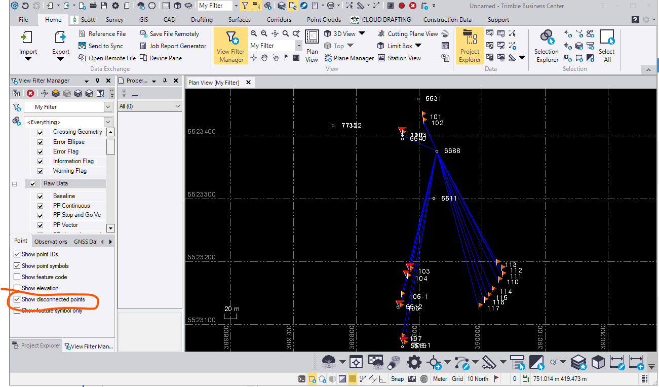

Scott Lehr's profile image
Scott Lehr
Hey Tyler,
I might add another option that I don't see in the thread here.  I have had similar problems with TBC project files with numerous JXL and job files and  importing a ton of Calc points.
My solution is more of a workflow but I think it is reasonable.
1 - Every day's data should be processed in an individual TBC.vce file. Do your control checks and base height checks here as it is easier to deal with than with a merged combined TBC project file.
2 - To delete Calc "Unconnected points" en masse do the following.
  • in view filter manager deselect "Show Disconnected points"
  • Once the disconnected points are no longer in the display view, type CTRL+A This will select everything on the screen.
  • Now Re-check Show disconnected points.
  • You should now see everything selected except the Calc points.  Next step is in the Home TAB select the Invert selection button. This will now reverse what is selected and you should only have the calc points selected.
From here you can Deleted the Points.
3- Now once you have cleaned up your individual days data, you should then merge it into you "master" or "Combined" file that contains all survey data collected.
Use the "Merge Survey Projects" button in the Survey tab to do this.
The end result of this work flow is better QC and cleaner more organized master TBC project files.
Hope this helps.
SL
