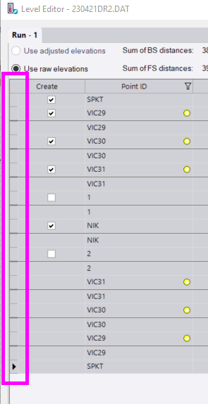

Having imported my data from a LEICA LS15 it would be handy if the data in the columns was selectable, so I could copy and paste out to excel.
You'll need to select it just via the slim front column and then Ctrl+C works.

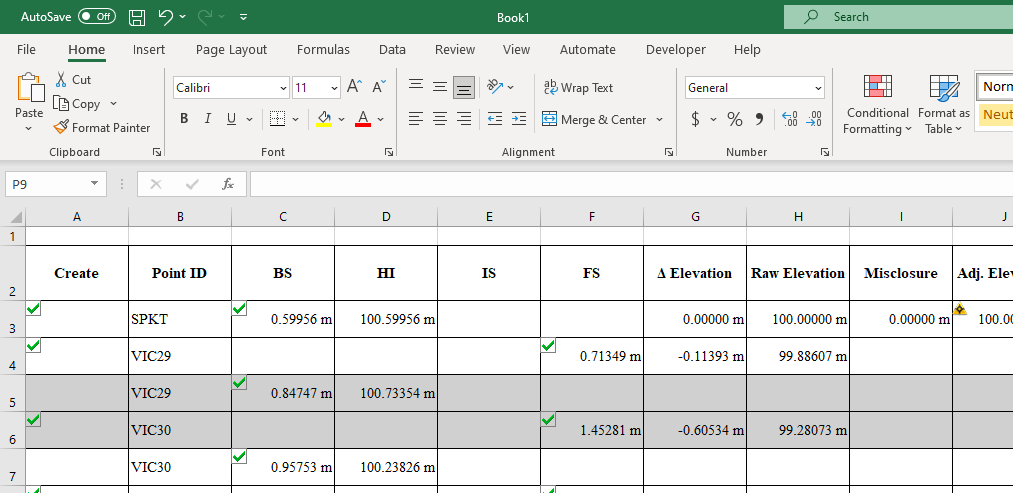

Or, once imported you can right click on the file and show the "Level Report" from there you can copy the table to Excel as well. You will have to do some cleaning though, remove the icons and probably search/replace the unit suffix.
