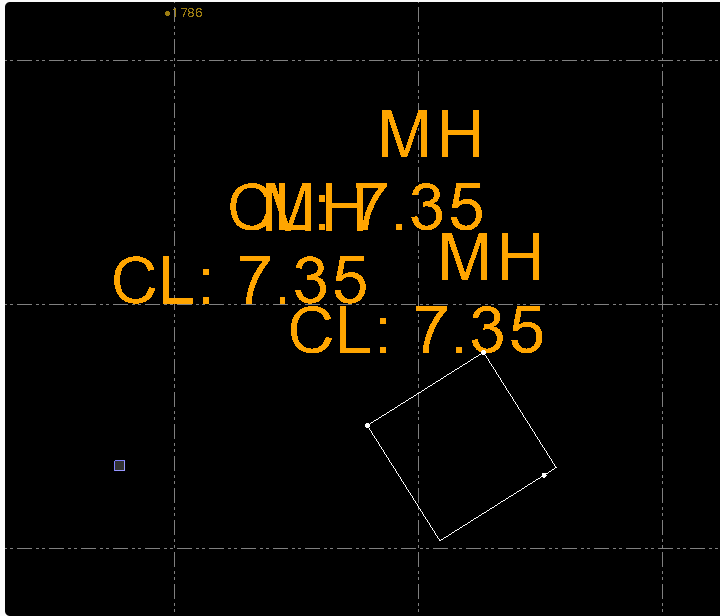

Using a 2 or 3 Point rectangular block we can achieve a utility lid drawn at the correct size and rotation, excellent!  At this point I am expecting that the software is programmed with basic logic and knows to label one of three points as indicated, though I am suspicious as I can't seem to find an option to select the calculated level which should be either:
1st Point
2nd Point
Last Point
Average
Highest or
Lowest
My suspicions are vindicated.
I have found a workaround in a thread but it is that a workaround.  This seems to be the most basic of survey feature code functionality.  Is it missing or is there a check box I have yet to find?
Thanks.

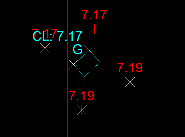

Wayne Bainbridge's profile image
Wayne Bainbridge
5.81 and I still don't think we can manage a manhole or gully.  Here is trusty Geosite, hard to believe this software is more advanced than TBC.
