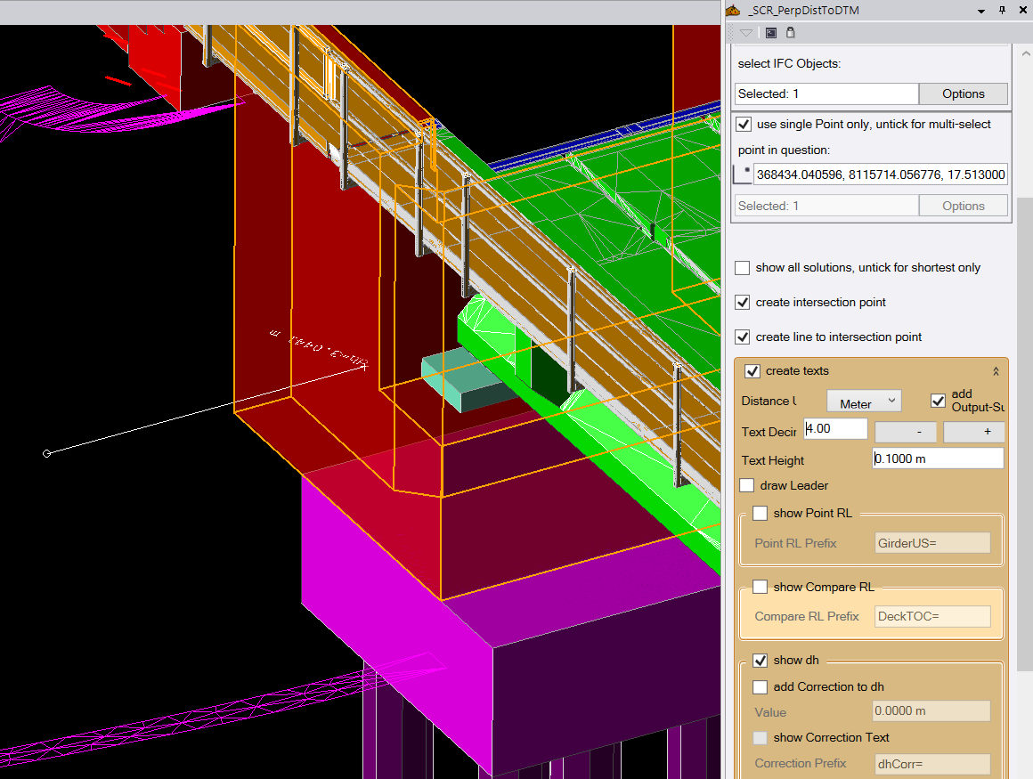

If you say "theoretical" point on BIM object I assume you mean perpendicular to it. That's nothing you can do out of the box.
You can try my "SCR_PerpDistToDTM" from my GitHub repo (https://github.com/RonnySchneider/SCR_Macros_Public), that works with surfaces and BIM . Minimum license you need to run Macros is "Survey Advanced".

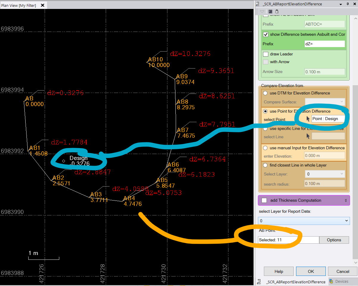

Usually my demands are even higher, so I wrote me a macro for this kind of stuff. Doesn't need the line, just a design point and at least 1 as-built point.
Naturally it only creates normal text's which won't change if you change one of the points.

Hi Ronny,
Your reporting tool worked like a charm! Brilliant.
Thanks a lot for the swift reply and your help. This does what I need.
Just would like to change dZ with just the Z= as text style but I assume I can find this in python coding.
Just change it in the green input field, where the tick box for Elevation difference is.
