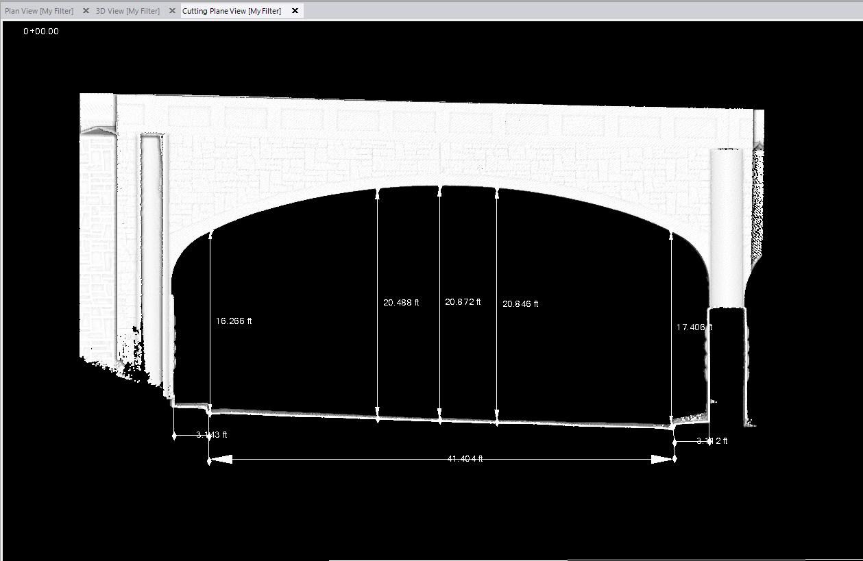

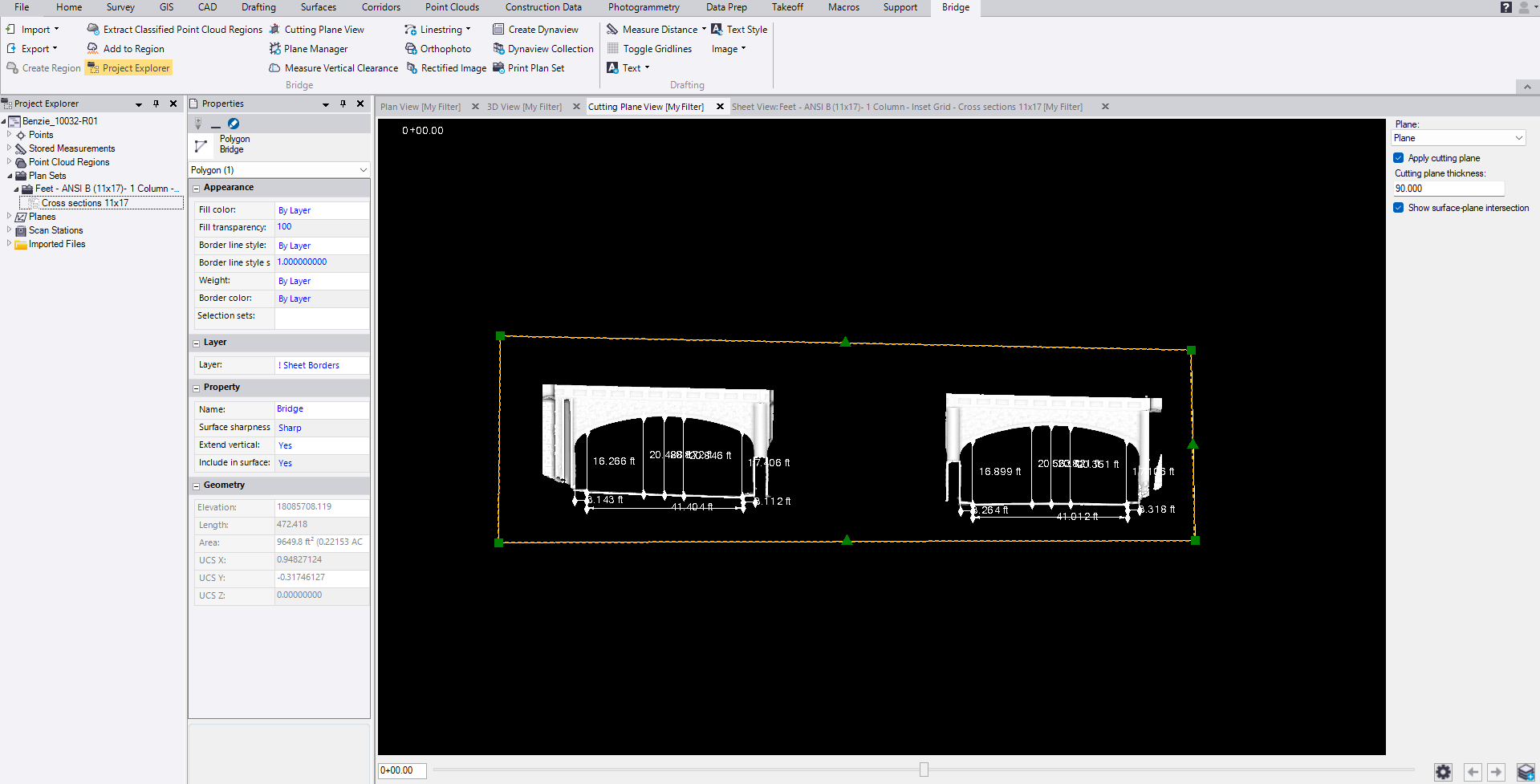

1a. In the cutting plane view I have a side profile of a bridge and used the measure under clearnce command to well... find the underclearance. Is there a way to edit the text so it displays along the line rather that perpendicular to it?
1b. In the cutting plane view I also have some measurements using the normal measure distance tool and want to either have the text get a background so the line nor the points don't cut through the text, or have a way to edit the displayed text.

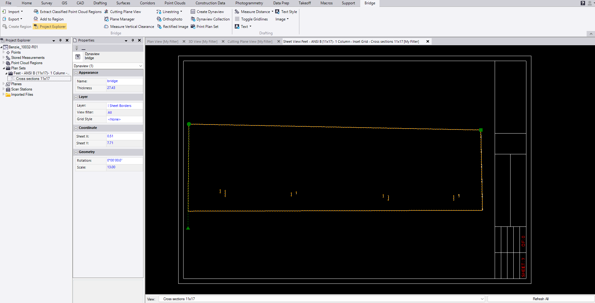

2. I then have a Sheet View with a dynaview of the Cutting Plane and for some reason all of the points and measurements are missing and will not display, Even when the view filter is set to all in the dynaview.
