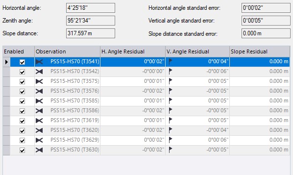

In TBC 3.61, If you had Control network data that contained 2 face round obs, if a Face 1 observation had a Vertical error of 5'" compared to Face 2 of -6" TBC 3.61 would realise that the resultant canceling out error equated to 1" so it wouldn't raise an error flag. from TBC 3.9 onwards this raises an error flag (>3" etc). The results being a sea of error flags that hides all the actual errors that the user needs to deal with. Is there a way of changing the settings so that the behavior in the new versions replicates that of 3.61?
See below, I would like the below not to flag just like in the old days (3.61). Having to review this kind of error just wastes my time. These cancel each other out.
Why does this flag? Face 1'a and 2' cancel each other out
