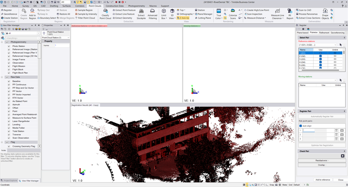

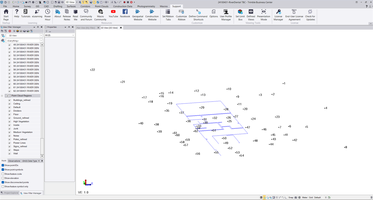

 My point cloud has disappeared.   All the data is still there but I cannot see it or click on it in my regular view ports.  I can see the points in the register screen so I know the data is still loading into the file.
Is there a way to refresh the points in my viewports?
If I reimport data will i lose my registrations and classifications?
No visible Points

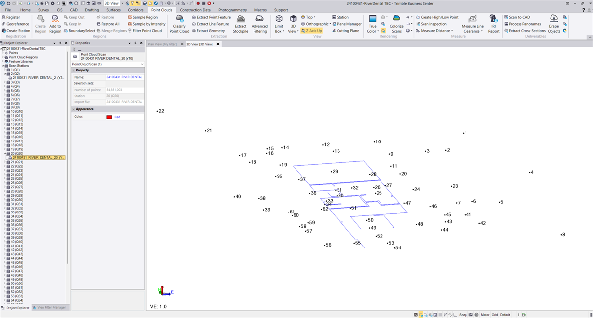

I have tried Restore all, Changing blending, rendering and shade settings.
All point cloud regions show up as having 0 points

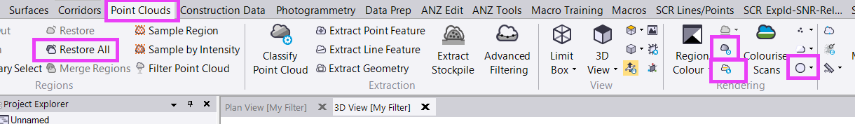

Have you tried one of the following options.
Try Restore all first.
Then toggling the intensity blending.
Then make sure the rendering settings aren't all up at 100%, but more around 50%.
