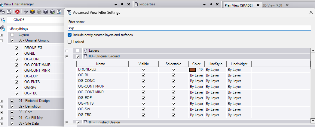

Is there an easy way to print a plan set in grayscale? There should be like a choice in the dynaview or something so I could easily print it in color or in grayscale. I still want my logos in color.

You have to setup a new view filter and change the Advanced View Filter Settings

Yes, I know that's one way to do it but I would like a way that I don't have to manually choose the color of each layer.

I have wanted this for years.  My quick fix was to save and change all my linework to plot to color white.  or I would plot in color and opening in my pdf reader.  From there I would save again but in grey scale.  Longer but has been the only way to go.   I though TBC was going to come out with a black&white plot option.
