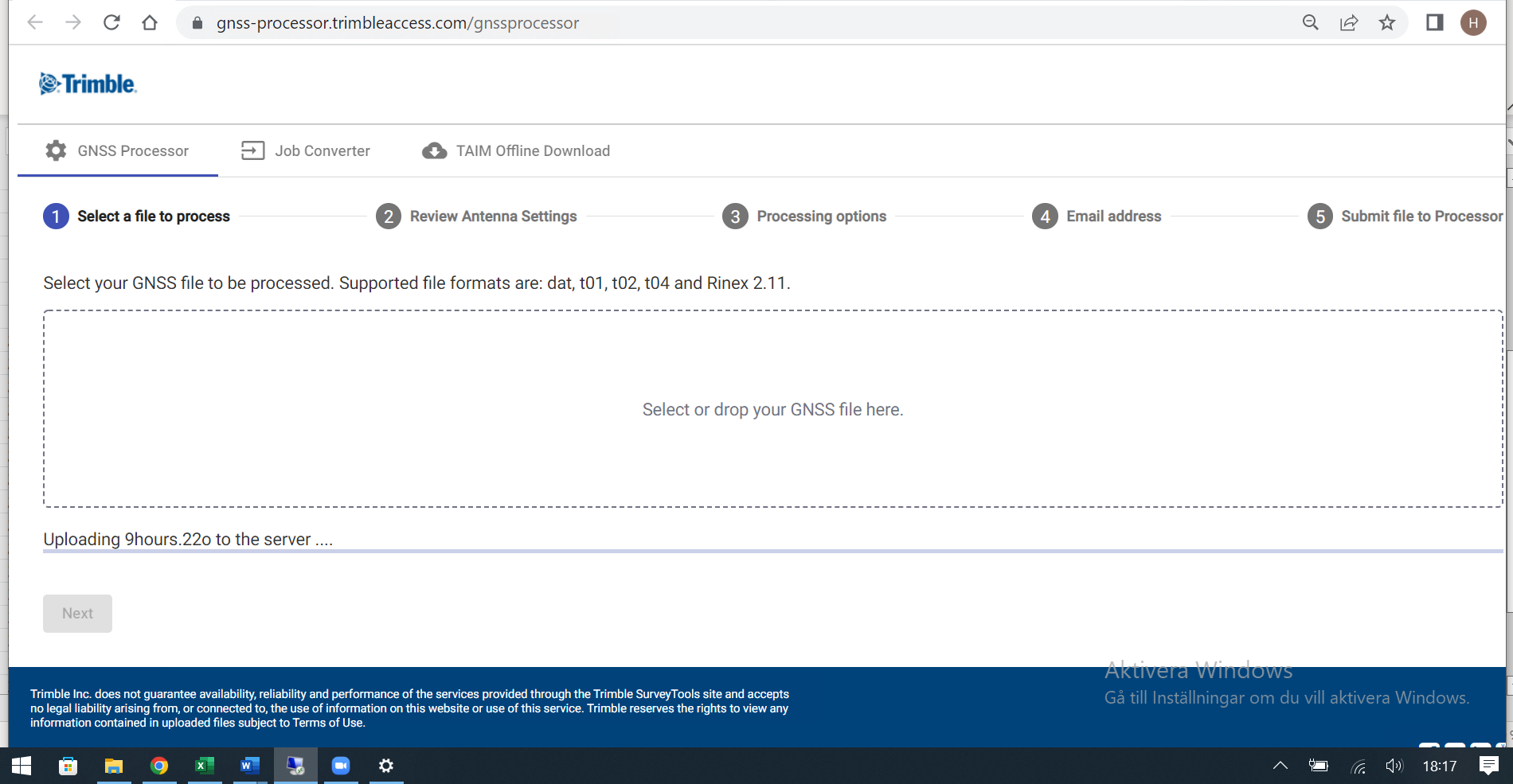

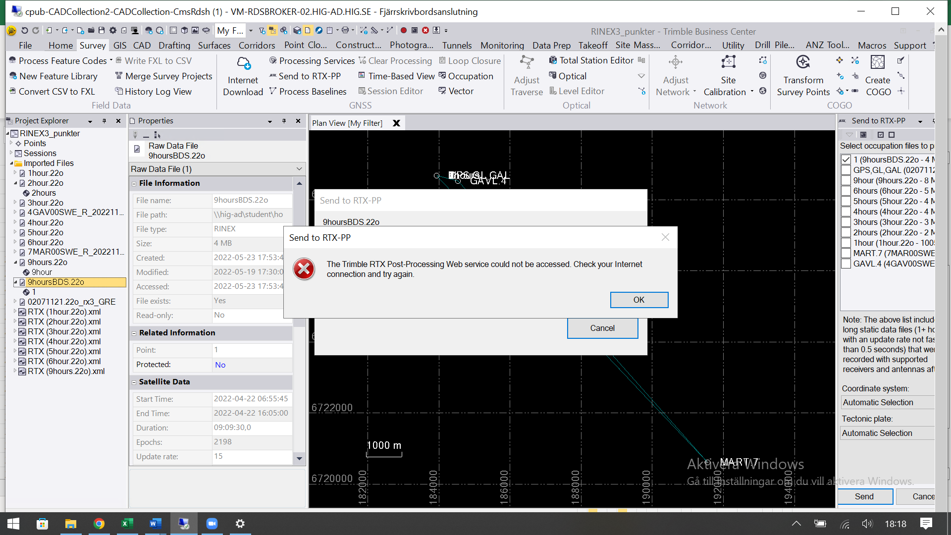

I have a problem!
I can not send my gnss file (only BeiDou) to RTX-PP and it does not work on "processing services" either. I sent the GPS file via processing services and it worked and I sent another file with all satellite constellations and worked on RTX-PP and "Processing services" and got OPUS solution in email but my Beidou file does not work.
I have attached a screenshots
It doesnt work on RTX PP when I send it, I get this error message
below.
The error when I am trying to upload the file on processing services. It just loads, but nothing more. I cant proceed to the next page

You can use TBC to do your own baseline processing.
