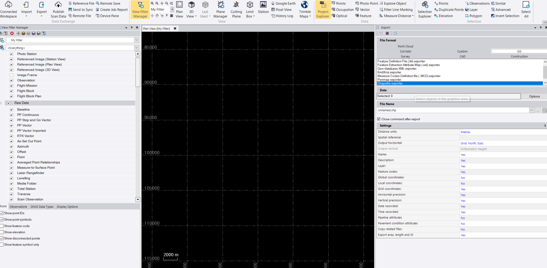

On Export of GIS shapefiles TBC feezes and locks.

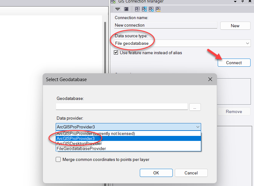

TBC 2024.10 and 2024.12 work with ArcGis Pro 3.4.
Just ensure that ArcGis works on your machine and you are signed in into your ArcGis Pro account using ArcGis Pro, then it will work with TBC too.
In TBC you can check if you have access using GisConnectionManager.
Try to create a new connection to a file geodatabase and check that ArcGisProProvider3 shows up:
Hope this helps.

Thanks for your help.  I do not have the GIS module installed, just exporting fronm the general shapefile exporter.
On exporting to shapefile with ARCGIS pro installed (v3.4) TBC 2024.12 causes a permananet hang.  On uninstalling Pro it works fine. There are several internet sources that suggest TBC and Pro piggyback off certain shared libraries.  When i roll back to Pro 3.2 it works fine.
Can you think of a reason why this is?  It happens with every single project I have tried.
