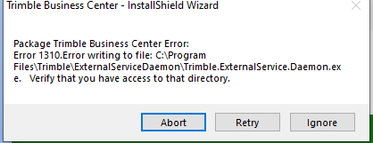

Hi All,
Has any had this issue when trying to install TBC5.90? Any help would be appreciated.

Hi Bob,
Yes I have full admin rights in this computer, I ran the cleanup utility and tried updating again. I did a quick search to find this file and it doesn't seem to be anywhere that I can find.
I have since reloaded TBC5.81 without any issues.

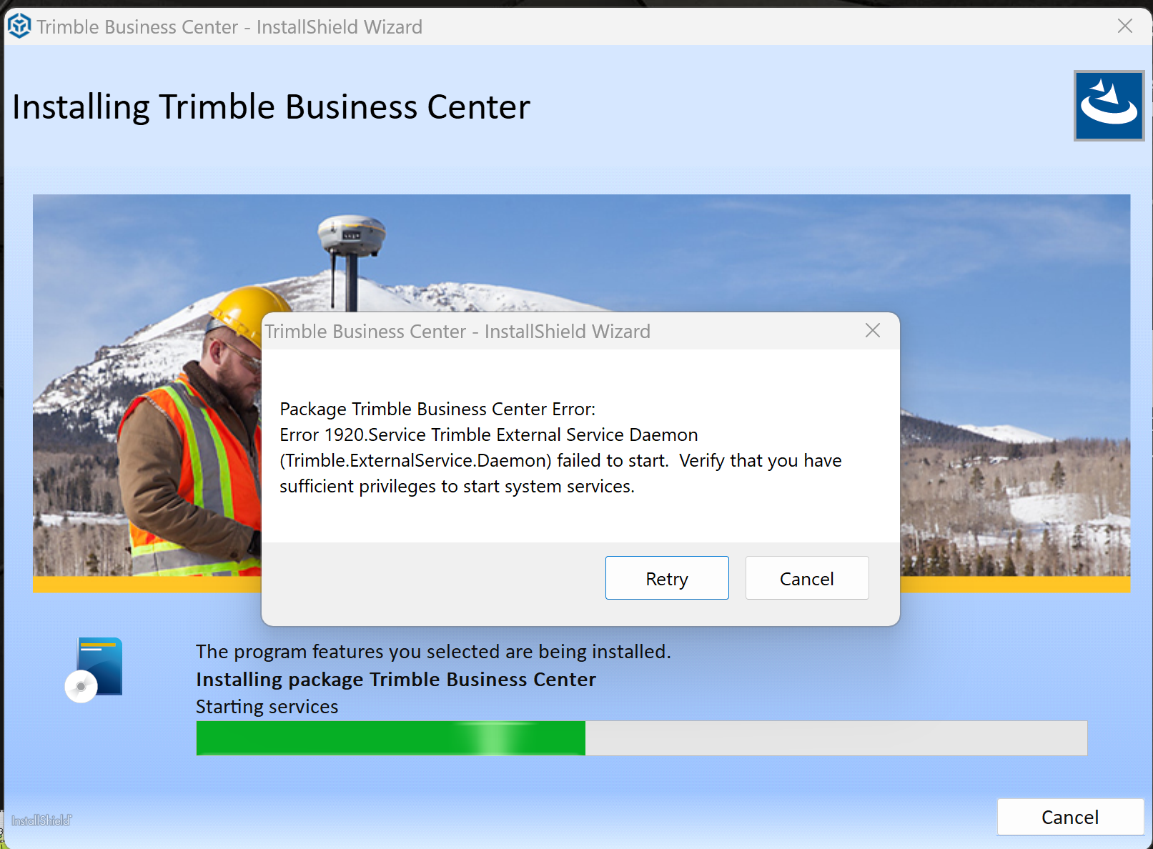

I received the same message while installing 5.90. I'm running the installer on my machine as a test before deploying it to users. I'm an admin and ran the cleanup utility.  I made sure the win installer service was running and now receive this message:

Got this from support:
1.) Search Services in the Windows search bar and select the app.
2.) Scroll to Trimble.ExternalService.Daemon right click and select Start.
2. B.) In this screen you can also select the properties to see the file path of the .exe, navigate there and make sure it exist and the user has full permissions to the file and folder. Once you find the file and folder right click on it and go to Properties, and the Security. You should have Full Access.

Thanks Shae, I carried out 1 and 2 and also was able to find the file and make the directory and file with full rights.
Tried the offline installer and received the same message. While the message was displayed I went into the services apps and that app was no longer there nor was the .exe file in the directory.
I have tried Both the online and offline installers without luck.

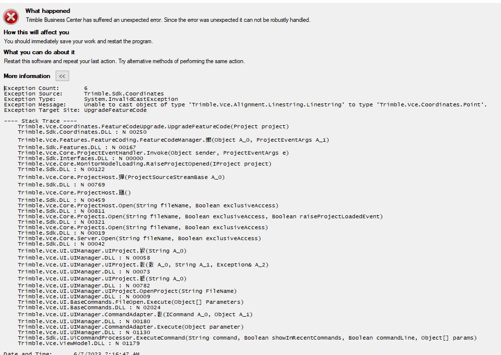

I got the same, downloaded the offline install then copied it to my C: drive and it worked. Spent the last half of the day working, saved my file, now I get this trying to open it this morning:

Lots of trial an error with this approach but  finally got an install:

Does anyone have webroot?
Nelson Hays's profile image
Nelson Hays
Yes, we run Webroot. Apparently you can no longer disable it temporarily. It pops right back on.
Lisa Metz's profile image
Lisa Metz
I had to disable all options in Webroot, reboot machine, login as an admin, run the 5.90 installer. Webroot will still flag the Trimble.ExternalService.Daemon, select allow, and then retry the installer which should run through successfully.

Here is a Support Note that was just released to address the issue:
Support Note - “Error 1920_ on TBC Installation
