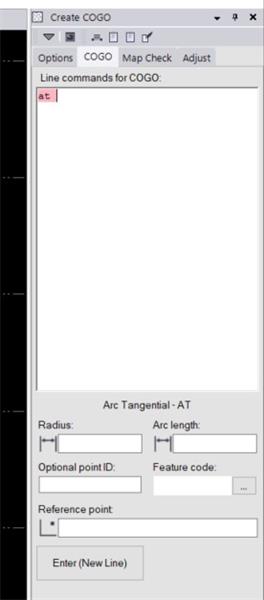

I have been utilizing the create cogo feature in TBC to plot maps. The ten key functionality is quick once you get the hang of it!

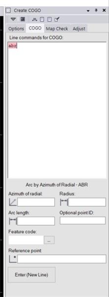

One issue I have run into is that often times curves are defined by radius /delta angle/ arc length. When entering them using the AT or ABR function I do not get the option to enter the delta angle. This leads to minor issues when labeling later down the line in C3D - The radius and arc length matches the map but the delta able is "calculated" by TBC and often off by a few seconds. I recognize the difference insignificant in the grand scheme of things.
Is anyone aware of a way to enter curves in TBC using the radius / delta/ arc length parameters using the create cogo program withing TBC?
