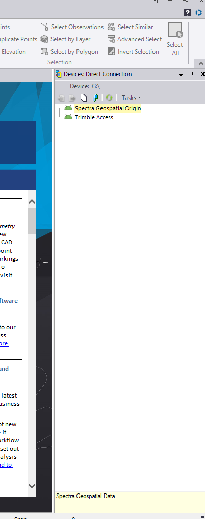

I am getting this screen when I plug a USB in with TBC running.
This freezes my program and is a pain when trying to multitask when TBC is processing and I want to download some data.
Can this be turned off? or at least set to exclude USB?

I have not seen the device pane lock up TBC before. Normally it will appear when you plug the USB stick in, but if you don't need it, you can close it. I don't think there is any way of disable it from within TBC. If there was it would be in the Options menu, and I don't see anything there that looks like it's related to the device pane.
The device pane will be triggered by certain folders on your USB stick. For Spectra Origin is will be the Spectra Geospatial Data folder and for Trimble Access it will be the Trimble Data folder. If TBC does not see these folders then it will not open the device pane. If you either rename these folders or move then into another folder then the device pane should not open when you plug in the USB stick. I would probably make them sub-folders of another folder on your USB stick. That way you will still be able use them with Spectra Origin or Trimble Access.

Sorry just looked at your screen snap again and noticed the Android icon. This means you are connected to a controller rather than a USB stick. While the controller is connected to the PC, go into USB preferences on the device (accessible from the Status bar at the top of the screen). From here you can specify what you want to use USB for (File Transfer, USB tethering, etc). If you set this to No data transfer then it should stop the Device Pane from popping up in TBC. Then if you do want to transfer some file to or from the decie, go back into USB preferences and set it to File transfer.

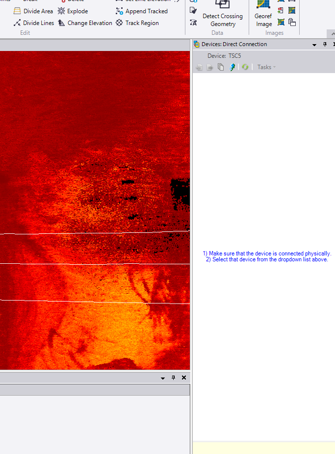

mine looks like this, and i just tried opening a second instance of tbc and it is frozen from the start. if i unplug the data collector tbc usually goes into a loop, don't remember the warning, something about the data collector getting unplugged, but i can not save or do anything in between the pop ups.

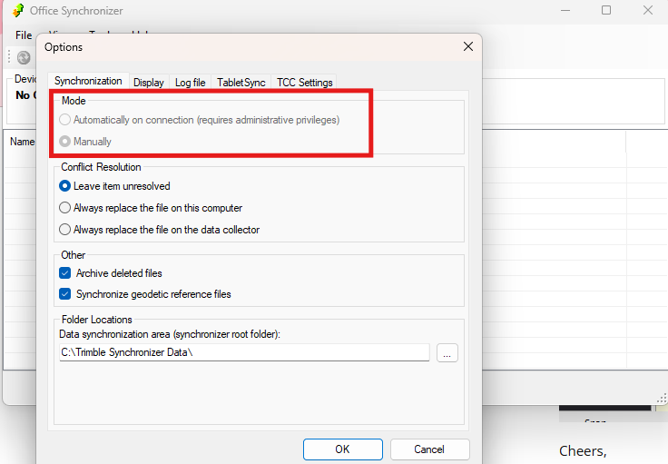

HI @ian bissonnette, I solved this by first changing the highlighted to manual. My colleague couldn't get it to work so he ended up uninstalling "Office Synchronizer" all together.
Hope that helps!
Dan

ok, thanks, i uninstalled office sync and at first this did not seem to do anything(the option to use 'manual' was just like yours, whited out, so i uninstalled it). then in tbc i clicked on the blue lightening bolt in device direct connect (tablet sync on/off) before having the data collector hooked on the computer, this prompted a windows firewall clearance, and after allowing the clearance i now seem to be ok. there is a lag when first starting tbc, but it is not a full freeze up. likely had to do with the firewall thing the whole time since this was not an issue on my last computer.
thanks for the tips.
