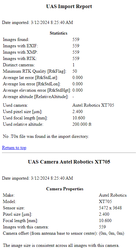

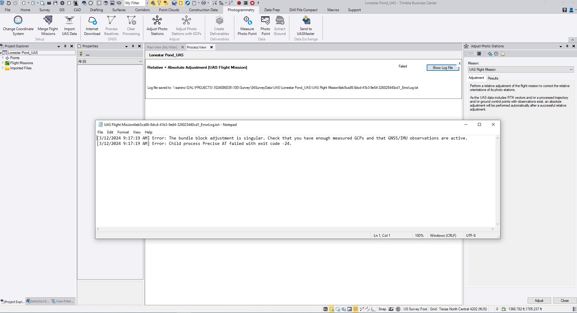

This is also happening to me while running the same TBC version.
I get the error below.
I only have the images in the import folder.
Here is a snippet of my import report.
