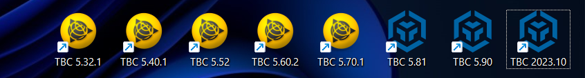

The standard TBC install folder is "C:\Program Files\Trimble\Trimble Business Center"
As soon as I've finished the installation of a new version I make a full copy of the folder and give it a distinctive name.
On the desktop I create a shortcut to the "TrimbleBusinessCenter.exe" in that folder, and only use those. I never use the TBC out of the standard folder.
