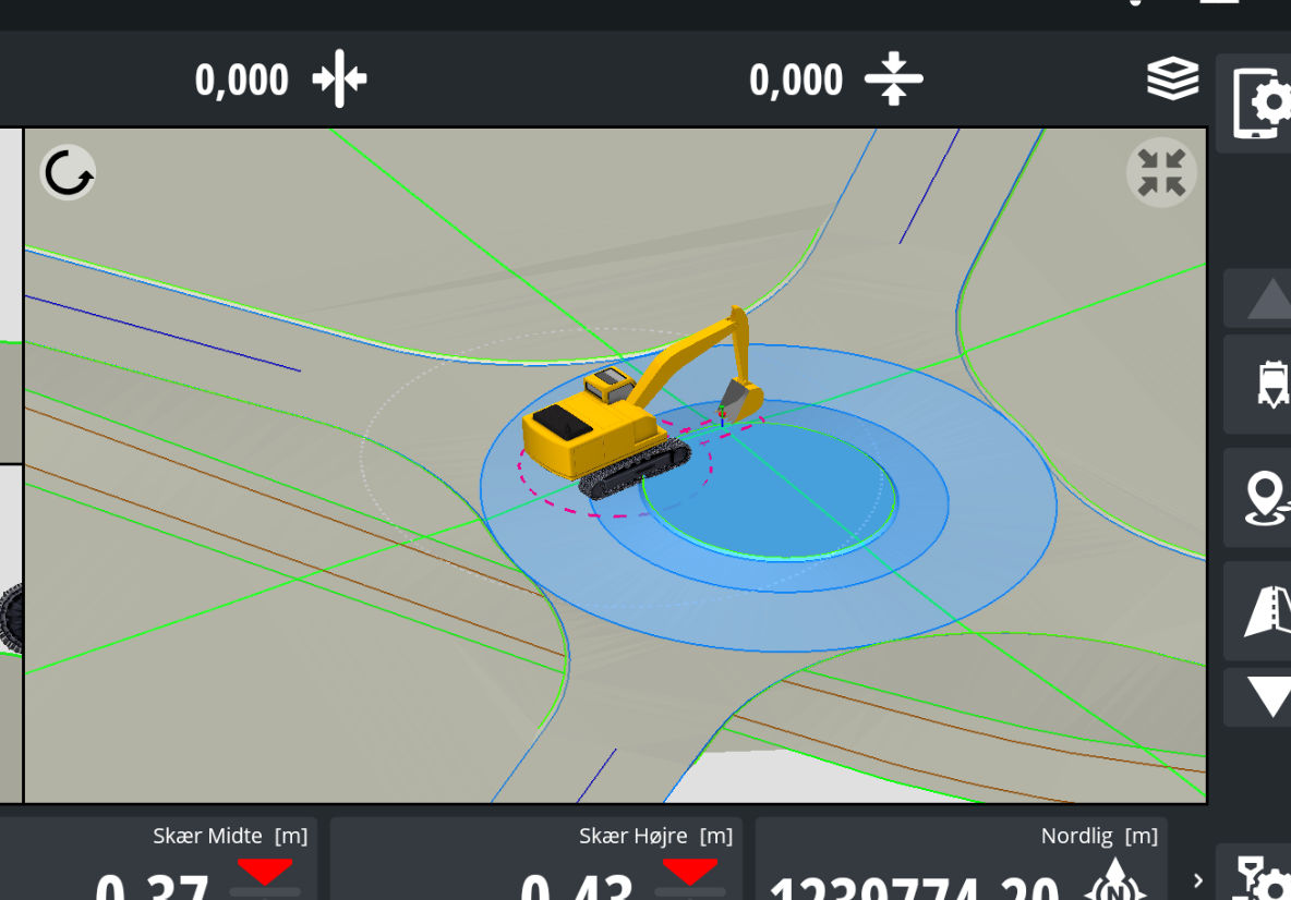

Hi Paul
I did a quick check, and it looks like your colored polygons need to set without an elevation. If they have an elevation it will not show in EW. Tested with TBC 2025.10 and EW sim 2.20.
