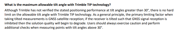

Here is the answer to my question (for the R12i), found in a customer FAQ for the R12i.
I was looking at data for the R12i, so this does answer my question.
