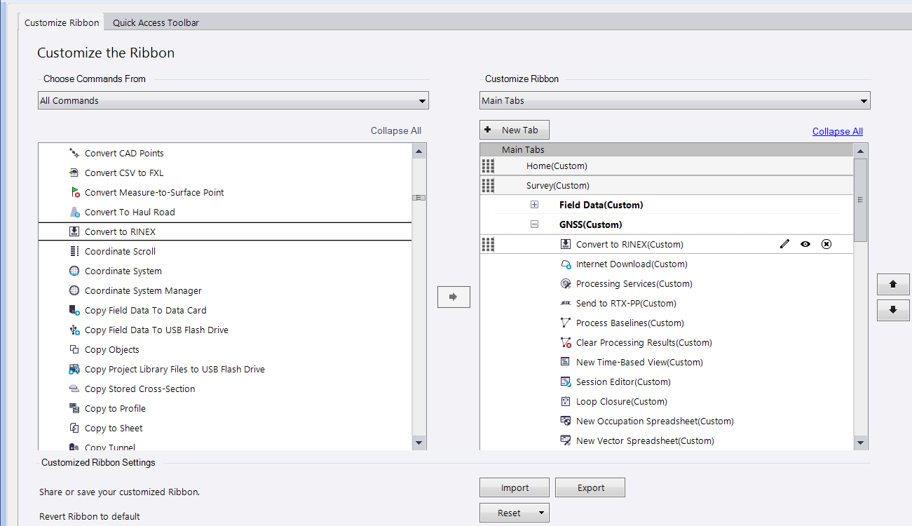

Hi Patrice, all I know at the moment is that you can install it along with TBC, as part of the GNSS Surveying program features:
I then added it to the Survey ribbon via Support > Customize Ribbon:

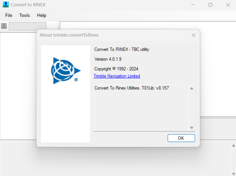

When I open it it gives me version 4.0.1.9.

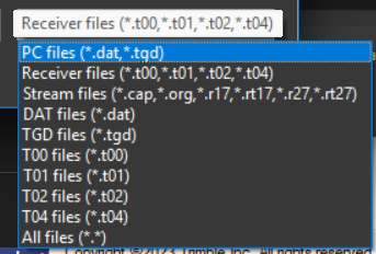

Depending on the source file format, you may also try the older Spectra converter, i.e. for some SPS receivers.
https://spectrageospatial.com/sp90m-gnss-receiver-2/
Is hosted on Trimble docushare server. And converter shows
The Trimble converter can write up to Rinex v4.01, the Spectra (Trimble) converter only v3.04.
